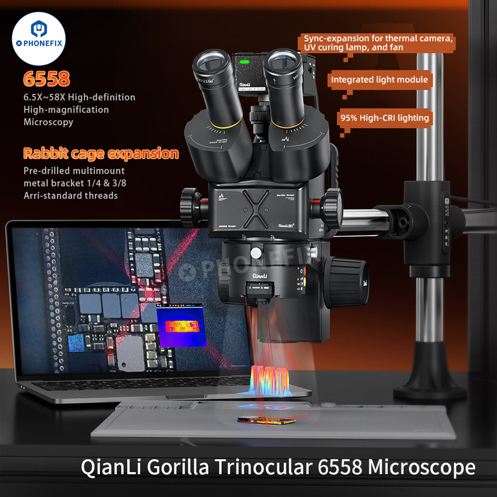

Qianli Gorilla 6558 Trinocular Stereo Microscope 6.5‑58X
« on: September 11, 2026, 05:17:49 pm »
I am shopping for a new Trinocular Stereo Microscope.
I found no thread about this Stereo Microscope 6.5‑58X which has some interesting features for electronics repair:
- integrated light 95% High-CRI module with
   - curing UV light
   swappable with
   - an integrated IR thermal camera (I assume it is similar to the Qianli Fire Eye Pro )
- power switchable USB-C ports for generic accessories management on Rabbit Cage metal bracket (1/4 & 3/8 Arri-standard threads)
- 6.5‑58X, with 0.5x or 0.7x "teleconverter" to adjust the working distance
- Laser coaxial 3D positioning
- adjustable diopter eyepiece 10x/23
- 4k camera available in bundle for the Trinocular
For less than $1K, it is very attractive to me, available in Aliexpress and other eshops.
Moreover there are some positive reviews on youtube.
I do not expect the optic quality of a Leica, but should be good enough.
Anything I should know before I pull the trigger?

One question is whether the stand will work for you or if you'll need to replace it with something else like a boom arm.
Issue I see with the UV light is you can only have the UV or thermal in place, not both. Personally I wouldn't want a thermal cam attached to a microscope, unless I had the money for a second thermal cam to use off the scope. ~$180 for the thermal cam module addon.
The price I see for the 6558 on aliexpress is $480 for a base unit with UV and 0.7x. I guess the 1k price is with all accessories.

I do not think you buy this because of the optics, but because of the versatility and accessories.
It is very practical to have immediately the IR cameras there for repairs, and all the rest is nice.
The UV light could be important in repair, but for me I would just leave the IR on all the time.
Maybe in the problem finding phase IR on, then in the repair phase swap it with the UV...
Looks like all the reviews i have seen are scripted.. I want to see details... pull some plastic covers see the mechanics etc..
same feeling, kind of... This is why I was hoping to find an owner with this post.
Still it remains a very attractive device for my needs.
