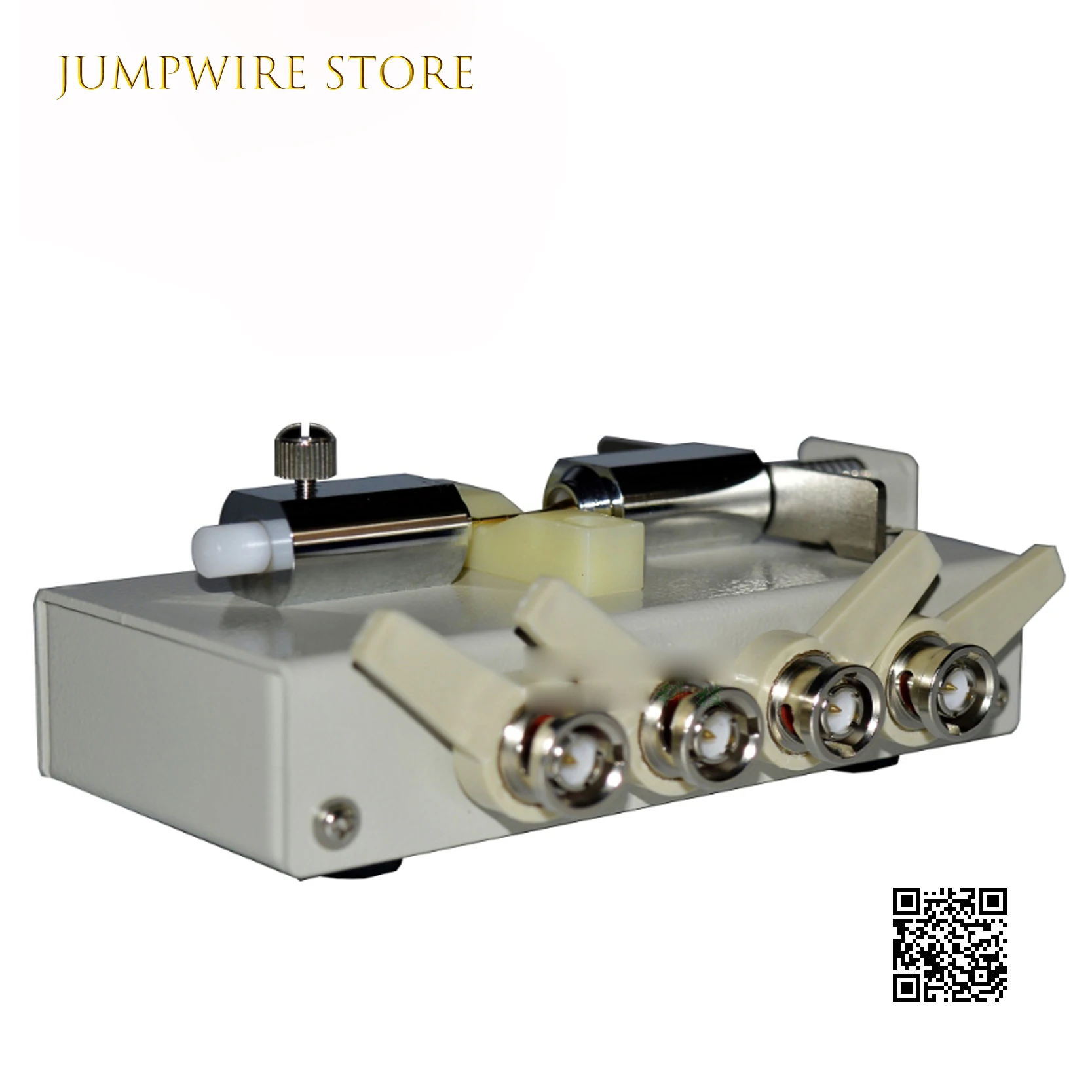

This fixture is only $60 from aliexpress:
https://www.aliexpress.us/item/3256802374699500.html
The following users thanked this post: biastee

« Reply #12 on: December 04, 2023, 09:40:36 am »
Those fixtures are configured for LCR meters, so they've got the interface for it and probably a lot less bandwidth than you'd want for RF characterization.  While proper fixtures are normally quite expensive, every so often you can find someone clearing out an RF lab with a bunch of custom fixtures for sale - may not be perfect for the parts you're thinking of, but probably cheap and designed for high bandwidth.
If I were trying the same, the PCB route seems like the best option.  It will be the closest to the configuration in circuit and you can build your reference planes on the same material/process, plus SMA PCB connectors are super cheap, so it's easy to just make a few boards and solder in parts under test.
