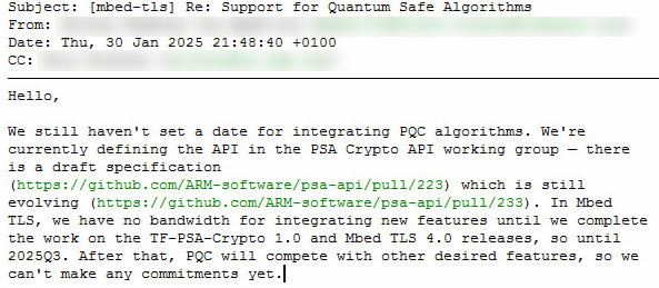

This is the latest thing in crypto... From the latest MbedTLS mailing:
Is it just huge RSA keys, etc?
The only defence against a fast computer has always been longer keys. It can't be different algorithms, otherwise why not use them right now? Well, except for the one time pad, but you have a key management issue there ;)

I repeat - do not bother for mbedTLS. If someone is using mbedTLS to encrypt state secrets, he has a bigger problem.
I just happen to be using MbedTLS and that extract in post 1 is from their mailing list. For sure nobody should be using an embedded product in some super secure application. The most likely scenario is the standard IoT stuff e.g. heating controllers, various telemetry stuff, etc. In the ref manual for my last project I tell people to only ever set it up as a client, never a server and never on an open port. You just can't be sure that 32F4 ETH + LWIP + MbedTLS is secure; there is insufficient deployment with open reporting going on.
