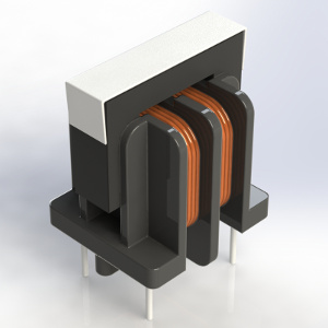

Hello, I have the TC-1 v2.12k, color TFT version. After a few minutes of using it went dead, opened it and found some bad solder joints in the LCD connection. It's working fine again, except the inductor test that shows wrong DC resistance. 7mH and 150Ohm with a inductor that reads less than 1Ohm in my multimeter. With simple resistors it works fine. Is there anything I can do?
The resistance measurement is the same for resistors and inductors. Have you checked other inductors too?
Yes, I have tried with two similar ones with similar results. The last one read 6.36mH and 148 Ohm while in my multimeter it reads 0.63 Ohm.  Don't know if it matters but both inductors are common mode chokes.
That's strange! I've checked a 2.7mH and 22mH common mode choke with the m-firmware an an older k-firmware. The measured values are reasonable.
