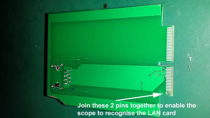

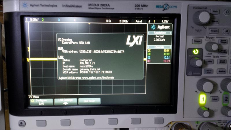

So, I made my own LAN card and of course it isn't recognised/displayed in the I/O settings like all the other DIY lan cards. I remember seeing a comment by Plesa about pin 78 appearing maybe like a 'detect' pin. Looking at the pictures Zucca posted, there's a 0 ohm resistor and from his measurements it make pin 78 ground potential.
Plesa mentioned he had issues when he connected pin 78/80 (he used kapton on other pins of his vga/lan card). Anyhow, I figured I'd try to connect pin 78 to pin 80 on my DIY lan board. I get no errors (that he reported), BUT I now have the dsox2000 recognising that there is a LAN card plugged in. Menu now has all the Lan Configuration menu stuff active. The IP address (static in my case) is being populated correctly as per my router setup as soon as I plugged in the lan cable.
I'll post up more details in a bit - just got this working and now need to play with it a little :)

Zucca, thanks for the pics and your connection info, definitely was what I needed to get my lan board running.
Here's the 'patch' to make the dsox recognise the lan card:
and this is proof :)
