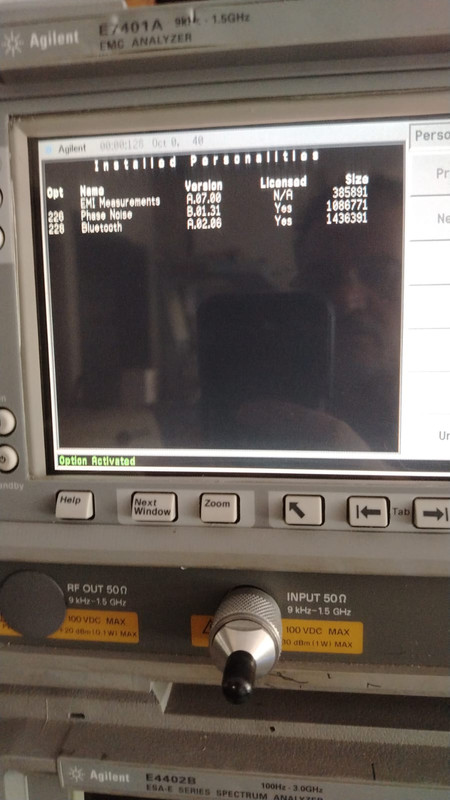

Ok, they are all mine it is not a company, but if you please can tell me in what page is where one can do the keys myself, I was reading and there is a lot of things mixed up. But I did succeed on the install of the personalities of the 226 Phase Noise and the 228 Bluetooth, If you can do the keys do the EMC analyzer E7401A of those two options.E7401A US41110459 Host ID B483E849.
I still have no feedback if I can produce keys for the EMC analyzer but let's give it a try, let me know:
226 20F74C24C04B
228 4EBB1EF6A459
Offline theamberco

« Reply #709 on: August 25, 2026, 05:15:09 pm »
Yes they work but the bluetooth option in a 1.5GHz is pretty much useless can you please give me the keys for the E4402B> MY45113849 Host ID A0122033. 226 and 228 so it makes some sense. Forget the other analyzer I cant even install the personalities as it has low memory.
