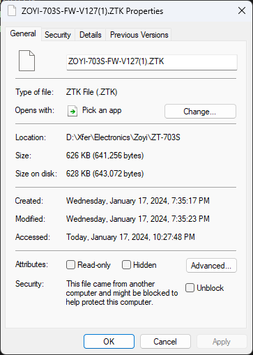

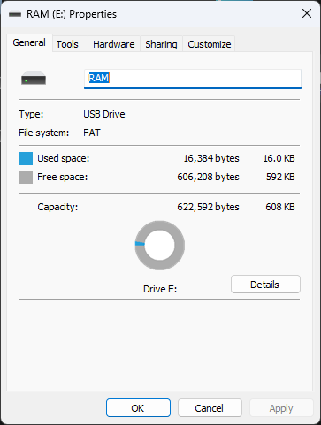

Same issue. The firmware file is 626K and there's only 592K of 608K total available.
The 702S firmware update was only 364K. Sounds like someone forgot to add a bit more flash memory to account for the 703S firmware size. Or else forgot to strip symbols or something from this build.

No, there is nothing in the flash drive other than an empty firmware folder and the hidden system folder that Windows always adds. Besides that, the total folder capacity isn't big enough to contain the firmware update file. It's only 608K total, with 592K free. The firmware file is 626K.
How big is the RAM volume on your 703S?

@Veteran68 and everybody else...
Randy222 gave me a clue...
Do this FORMAT the device (this will clear out images)...
Then in the oscilloscope Menu system go to USB and click the F3 button to Enter it...
Then Drag and Drop (copy) the ZOYI-703S-FW-V127(1).ZTK to the FIRMWARE folder
ZT-703S "should" say upgrading do not power off...
Voila... It should be upgraded...

I did no formatting, my 703 is out-of-box, less the v127 I just installed.
My win10 shows 703 flash drive as "14.393MB capacity". I will assume the 703 has a 16MB ram/rom chip.
With v127 installed flash drive shows just north of 10MB as free, and just north of 3MB as used.

This is all very interesting. I wonder why some of ours show such a small 600K "RAM" volume when the apparent capacity should be ~16MB. As I said, and as you can see from my screenshots, other than some hidden 16K filesystem overhead there's nothing in mine.
When I get home today I'll try to format approach and see what happens. Odd that it doesn't come formatted out of the box, yet has the firmware folder in place like it's been prepared to received fw updates.

My hunch is that maybe you (Randy222) upgraded the firmware right away therefore you had no problem.  Whereas Veteran68 and I maybe saved a few waveforms testing out the device.
Not the case for me. I'd saved nothing, ever. In fact since I got it I've done little beyond turn it on, and test the UART function as discussed before. I have a 702S already so was familiar already with the function, and hadn't had a use for this one yet (I collect far more than I use, I have somewhere around 35-40 handheld DMMs/scopes).
It's telling that our out-of-box experience is one where the volume is labeled "RAM", contains just a firmware folder, and is only 608K in capacity. Whereas post-format it's labeled FLASH, has multiple folders, and is 16MB in size. So either Randy's left the factory later and was formatted properly (possible, as mine was a preorder and may have been an early unit), or he'd already formatted it, perhaps not realizing or remembering. Curious to hear from others as to how theirs is formatted out of the box.
