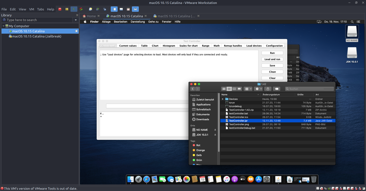

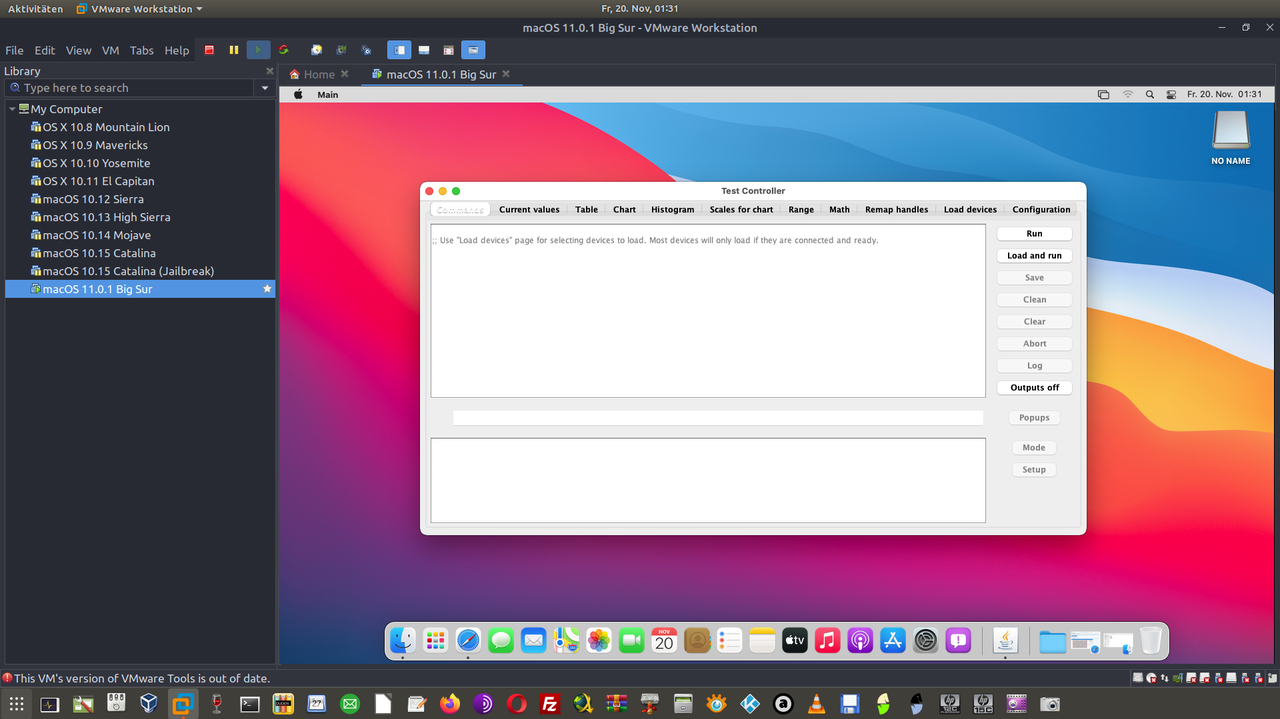

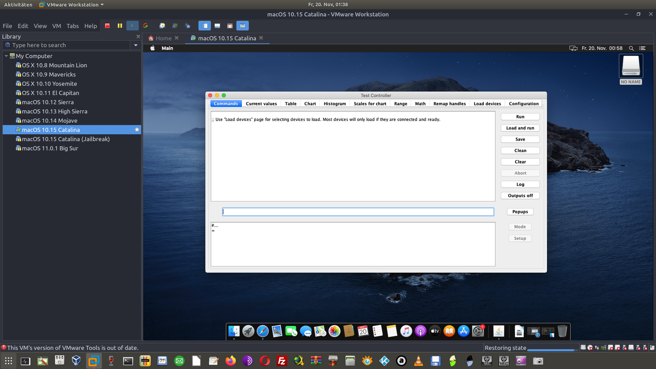

Offline PushUp
  • Posts: 250
« Reply #1311 on: November 20, 2020, 12:50:35 am »
Without doing any further trouble shooting, I can confirm, that it has something to do with Big Sur...
...as Catalina works fine:
Cheers!  :-\
