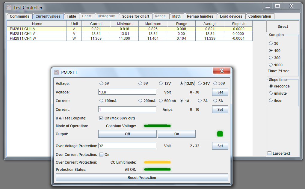

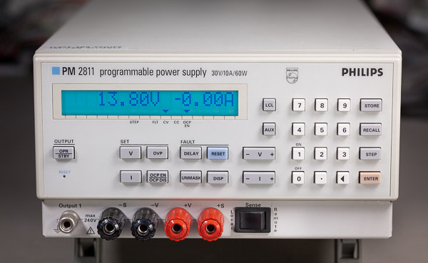

Online Gertjan
  • Posts: 378
« Reply #3113 on: August 31, 2023, 08:27:32 am »
Hi HKJ,
I am working on a definition for a Philips / Fluke PM2811 programmable power supply. It is SCPI compliant, and I am using the R&S HMC8043 definition for guidance.
This power supply was sold in several versions: 30V/10A and 60V/5A, front panel and back panel connectors etc. All these versions are having a bit different type number, and thus give a different answer to *IDN?.
Philips PM2811 30V / 10A:  PHILIPS,PM2811/01
Philips PM2811 60V / 5A :   PHILIPS,PM2811/11
1. Obviously the 30V/10A and 60V/5A versions need a bit different definition.
Would this work:
; Meta definition for PM2811 30V/10A version
#metadef
#idString PHILIPS,PM2811/01
; Meta definition for PM2811 60V/5A version
#metadef
#idString PHILIPS,PM2811/11
Would TC automatically pick the right #metadef, depending on the *IDN? Answer?
I suppose the easy way would be to create just two model names: “Philips PM2811 30V/10” and “Philips PM2811 60V/5A”. But that seems to be a less elegant solution.
2. The second digit after the slash can change too…
Probably it means "front- or back panel connectors". But it could also be "Country Version" (In the full Type Number there are 3 digits after the slash…)
Anyway, the value of this last digit is not important for the definition. (No changes in the definition are needed when this digit changes)
But with a different *IDN? Answer TestController will not recognize the device…
So, is it possible to “mask” this last digit when TC does the device recognition with *IDN? Or is there another solution?
3. These power supplies were sold by Philips, but after the Fluke/Philips T&M alliance, they were sold under the Fluke brand. (In practice, I see more Fluke PM2811 than Philips PM2811).
However, also with the Fluke version, the *IDN? Answer remained PHILIPS,PM2811/xx
So, would you like to have both the Fluke and Philips version in your supported list?
And would coding like this work, as both #metadef’s are having the same #idstring:
; Meta definition for Philips PM2811 Power Supply
#metadef
#name Philips PM2811
#handle PM2811
; Meta definition for Fluke PM2811 Power Supply
; As far as known the later Fluke versions kept "PHILIPS" in de *IDN? answer string
#metadef
#name Fluke PM2811
#handle PM2811
Thanks in advance & regards, Gertjan.
edit: added the info that PM2811 is a SCPI instrument.
« Last Edit: August 31, 2023, 09:56:43 am by Gertjan »

Online HKJTopic starter
  • Posts: 4976
    • Tests
« Reply #3114 on: August 31, 2023, 10:03:24 am »
Would this work:
#metadef
#metadef
When you select you equipment on the "Load devices" page you select the correct *idn? answer, TC can also automatic pick a matching *idn? answer in some cases.

I wrote a device configuration file for the Fluke / Philips PM2811 programmable power supplies.
It is based on the R&S HMC8043 definition.
These supplies exists in 2 versions: 30V/10A and 60V/5A. I wanted to combine both versions in one definition. The PM2811 has SCPI commands to query the maximum output voltage and current. Idea was to use the answers from those in variables, and use them in the menus as "maxVolt" etc. But I was not able to get this working. So now, as a bit less elegant solution, there are two different #name for the two versions.
Although this is an older power supply (introduced in 1991), it is quite speedy over GPIB. Using AR488 I get 5 read-outs per second. (V, A and W)
Divergent from the R&S definition I choose to NOT turn on the outputs with the quick select U and I radio buttons. I feel that one should first set up a power supply, and only after that, and when needed, switch its output on. Mostly to prevent accidents  :).
The PM2811 protection works different from the R&S, and is more extensive. For Over Current Protection, one can choose between just current limiting, or switching the output off after over current.
The protection status indicator will show in detail what is wrong: Over voltage, Over current, Over temperature, Out of Sense or Calibration invalid.
There are also 2 and 3 channel versions: PM2812 and PM2813. These are big modular 19” units, with several output channel options. So these are too complicated to include in this definition with #metadefs. Especially without any means of testing...
It should be easy to create a definition for these, based on this definition, and using the 3ch R&S HMC8043 definition as a guide. To facilitate this, all the Output Channel selection commands are retained in this definition. (Here all CH1, the only Output... :))
Please find the definition file here: Philips PM2811.zip
Regards, Gertjan.
« Last Edit: September 08, 2023, 05:41:37 pm by Gertjan »
