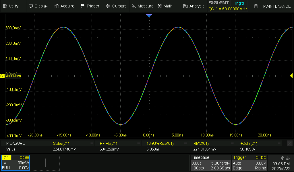

Should I be concerned about this intensity fluctuation at all? Do I need to improve filtering or something in the SML? I see similar movement from the SDG, but the intensity color grading is generally consistent.

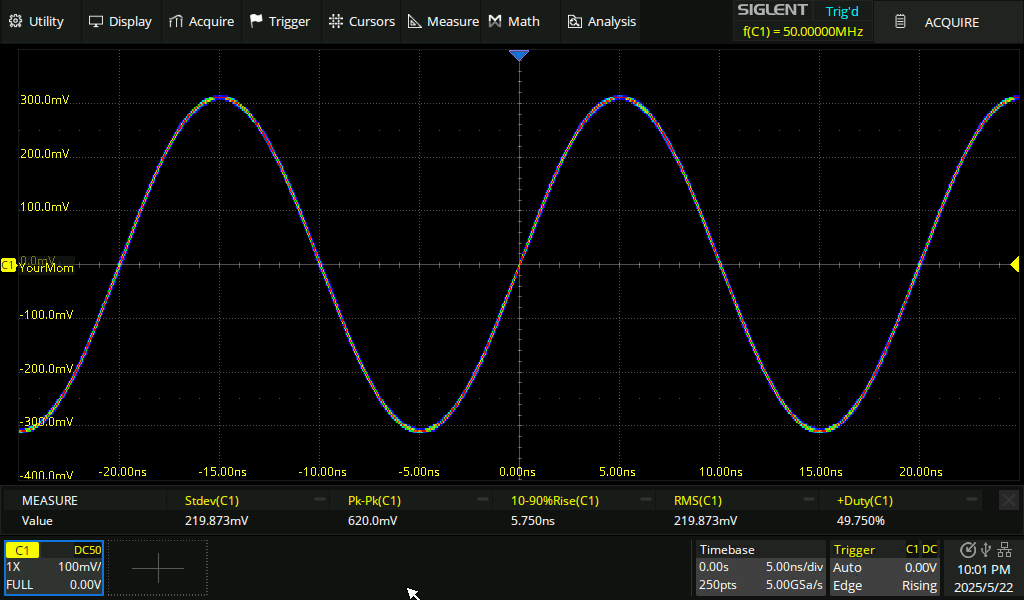

Offline KungFuJoshTopic starter
  • Posts: 8194
  • TEAS is real.
How's this look? Did I set it up correctly?
SML03:
SDG2122 for comparison:

Offline kmoonwalker
  • Posts: 448
hmm you written some time ago about it being able to modulate the waveform etc - did you disabled all tricks from settings after playing with fancy signals? ;)
other than that something maybe broken (or cable or something on signal path is not good enough and scope reacts to that)
also thing that I noticed (but it maybe due to not some huuge signal amplitude and scope approximation) - the amplitude is fluctuating a bit - from my university time old Rohde generator was so steady we tested all new ones against it and they usually failed ^^
« Last Edit: May 23, 2025, 02:08:25 pm by kmoonwalker »
  • Posts: 8194
  • TEAS is real.
I think you hit the answer right there. I connected both gens with 50MHz 0dBm signals to my scope. Look at the Vrms stats, that looks pretty clear. A small difference, but a noticeable one, and not in the direction your experience would suggest.
It's probably obvious from this conversation that C1 is the SML03, and C3 is the SDG2122X.
Now, the question is, how can I stabilize that voltage further?
