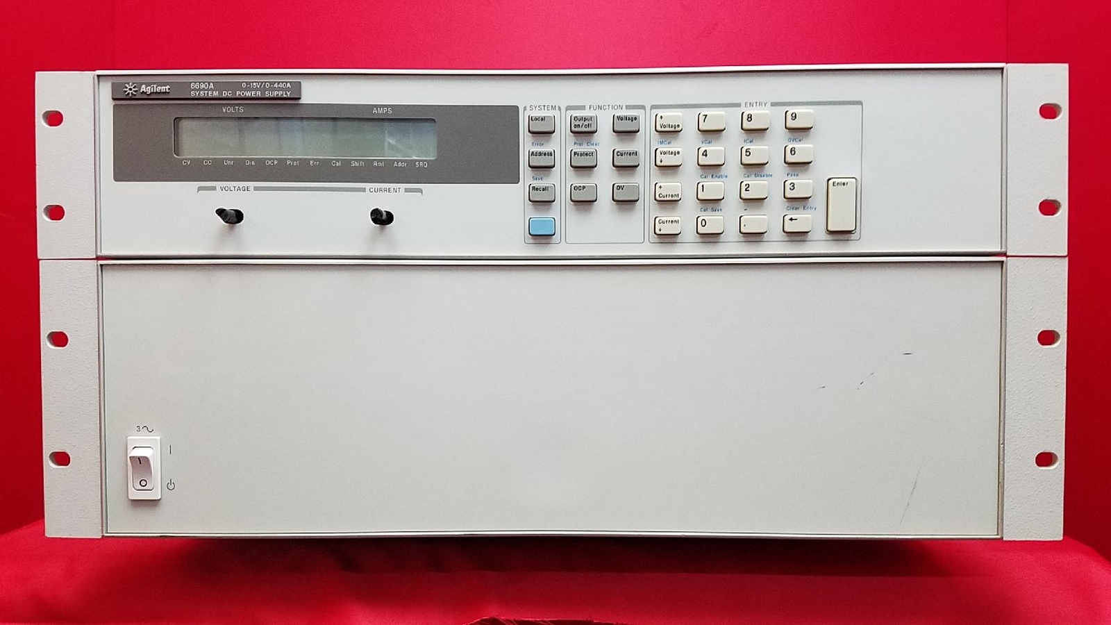

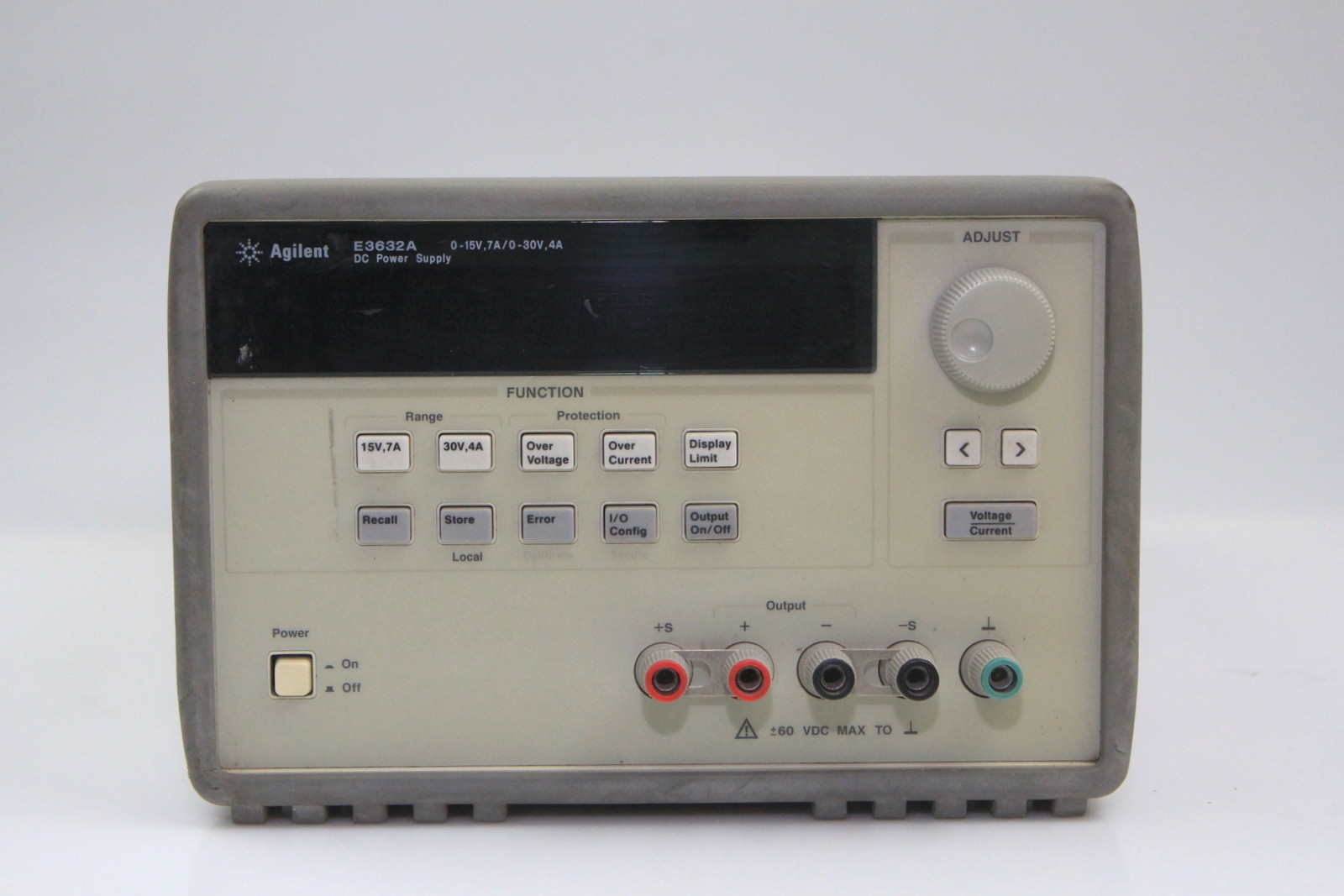

I'm in the market for a new power supply myself. I still need one that's accurate, computer controlled and has remote sensing. I missed that last requirement when I bought the last otherwise very nice one. Maybe it's time to finally spring for a HP, Agilent or Keysight one.
« Reply #16919 on: September 26, 2018, 06:21:44 pm »
After the same. Patiently waiting for an affordable E3632A to go past. They work nicely with a shitty serial USB dongle.

https://www.ebay.com/itm/362336982127
You mean like this one? AS-IS DOA, visible chunk damage, visible water damage, ONLY $313!!! and coming from Israel, so ONLY 4 weeks delivery time!!!    :-DD
Sometime around Halloween, you MIGHT receive a box that DOESN'T have a medium-sized rock in it!!!    :-DD :-DD
Worse yet, you might actually receive the brick of toxic waste shown in the pictures!!!  :-DD :-DD :-DD
Jeezus... talk about putting your garbage up on eBay instead of in the dumpster where it belongs...  :palm:
"Another fine listing by Fuckwits-R-Us !!!"

To be fair shipping is a large part of the costs, but that doesn't change the fact that the back looks like it has been sitting in salty water. I've seen more items sold from Israel at stupid prices. Either electronics are very expensive there or they're not quite in touch with the market.
« Reply #16922 on: September 27, 2018, 12:14:39 am »
Yeah, but their crazy shipping costs aren't my problem. I didn't ask them to try and sell their burned-up crap halfway 'round the world on MY side of the platform.
