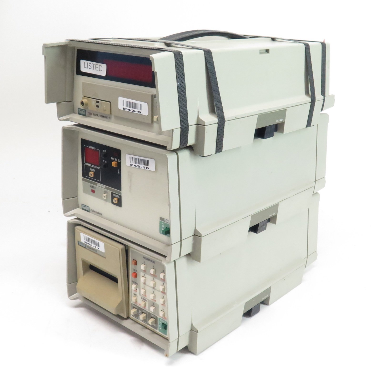

That Fluke is the Face and Body a Mother would put a bag over and leave on the steps of the orphanage  >:D
There is also the Temperature version too, just what drugs was the industrial designer on  :-//

Looks like the arse end of a Star Trek shuttle.
did they make them that way so that you could stack them and lock them together?

There is a series of them including a Clip on Battery module. Rude little Frogs  ;D
The Next Generation is 'better'  :o
I don't know, but he probably used a Hypospray.
LOL! That it does, except for one thing...the shuttlecraft looks better. Nah, they're both ugly. :-DD
