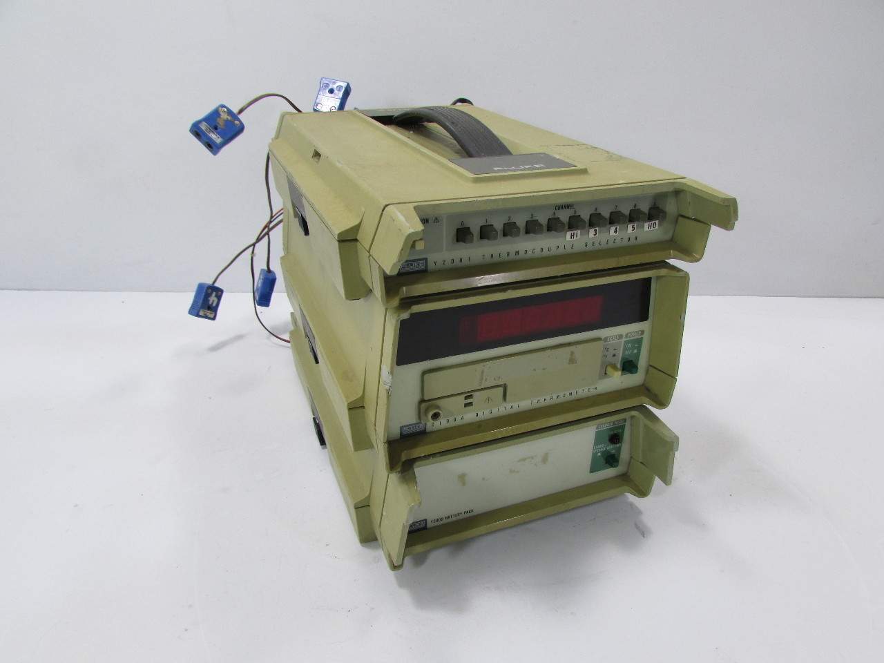

Offline Ero-Shan
  • Posts: 571
« Reply #35061 on: July 18, 2019, 07:22:16 am »
A big shout out and thank you to Nixiefreqq.  :-+ :-+ Here it is. Fluke 7260A. I got so many goodies today I don't know what to do next.  :-DD
But anyway, at some point I'll do a tear down.
Boy, is that thing ugly!
But I certainly wouldn't say no to one.  ;)
You can be really grateful to Nixiefreqq Very generous. And don't forget the pictures!

« Reply #35064 on: July 18, 2019, 07:36:33 am »
He will need to be careful they mount each other and produce mega ugly babies  :-DD
Yes, certainly not what you would call good looking. And that stack is hideous.  :-DD Bd described it as looking like the Star Trek Shuttle ready to take off. Good analogy.
I'll do a tear down as soon as 2 things happen. First, I find a manual. So far no joy. 2nd, I can't figure out how to get the damn thing apart. I tried with no success. So hopefully once I source a manual it tells me how to get it apart.

  • Posts: 4576
« Reply #35070 on: July 18, 2019, 08:41:27 am »
 :wtf: :wtf: :wtf:
-Pat
What is that Fluke in the middle of this mess, err, genius arrangement?
