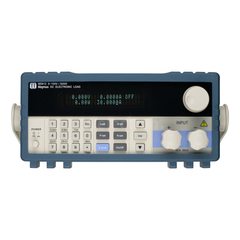

@tautech:
I think, I'll order next month an electronic load from Maynuo @Welectron.
This one: https://www.welectron.com/Maynuo-M9812-Electronic-Load
What do you think is a similar device (tech-spec wise) from Siglent?
What would you recommend?
Thank you for your answer.
Could I perhaps interest you in a Chroma load?
Thanks, those are nice units but they do not fit my specs. 60V is too low for what I need.
Btw, I had already checked out your store, I always do this on a regular basis.  :D  :-+
I have two electronic loads: A Zentro ELA 40/40D (40 V/ 40 A, 200 W) and a TET 60 V/ 100 A. Alas the latter is dead, and there's absolutely nothing to find about it. I opened it once and and looked for something to measure, like a supply voltage, when suddenly both supersonic wind tunnels sprang into action, startling me to death. :o Still, it didn't work. And even after looking for half an hour, I hadn't find a way to disassemble it. My relationship with mechanical engineers is a bit strained. ;)
I sure would like to have a load that works at a higher voltage. I don't need 100 amps, not even 40. Say 400 V/12 A should satisfy all my needs.

Wonder if it is possible to cobble together a relatively simple "high voltage front end" for a regular electronic load?
