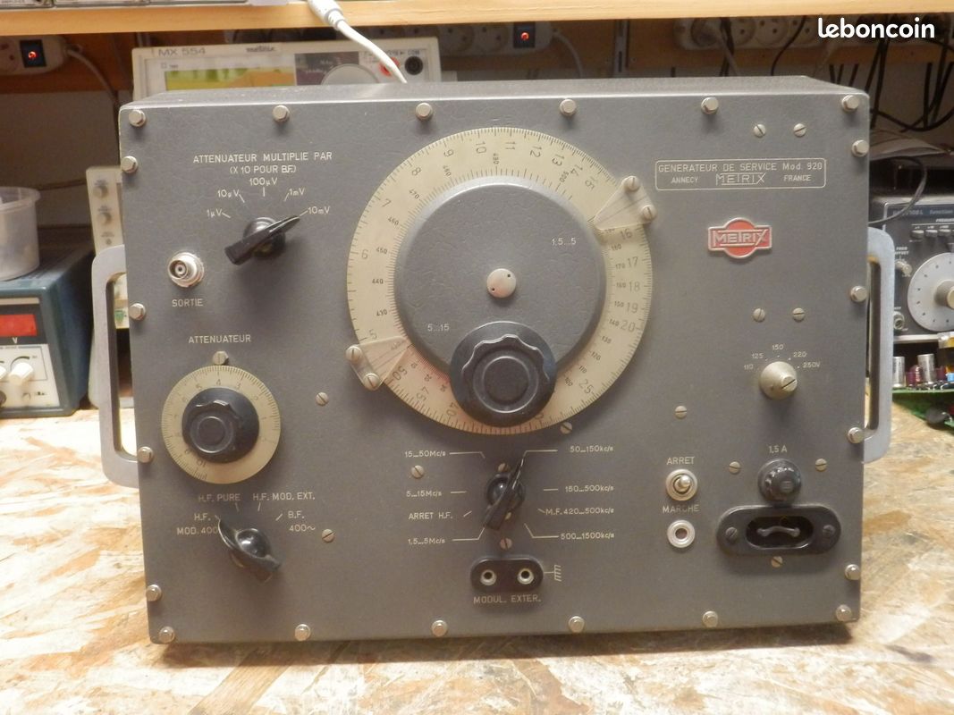

Nice Generator that old Metrix indeed.... but indeed makes no sense for me to pay a fortune to import it.
It's very common here in France and worth 50 bucks / Euros and even at that price, nobody wants them.
Plus I can't buy boat anchors any more... ran out of space, no, seriously... if I ever buy another boat anchor then it would have to be something really exceptional.
Like my old Tektronix 575 transistor curve tracer, for example. If I find another one of those for parts, cheap and local, yes I would take it in a heat beat. But of course that will never happen so this is all rhetorical...
But a Metrix sig gen nah, just doesn't make sense.
I have its little brother a Metrix type 920. Much more compact / lighter, less features but same specs / performance (50MHz, AM) and design / era basically..... like new, overhauled, works fine... been trying to sell it for 40 bucks for months, no takers what-so-e-ver. I will soon give up and scrap it for parts  to reclaim the space   :(  If someone wants it.... paid 30 Euros for it, then paid 10 Euros to replace the oscillator tube with a NOS. My loss, your gain.
https://www.leboncoin.fr/bricolage/2417290980.htm
