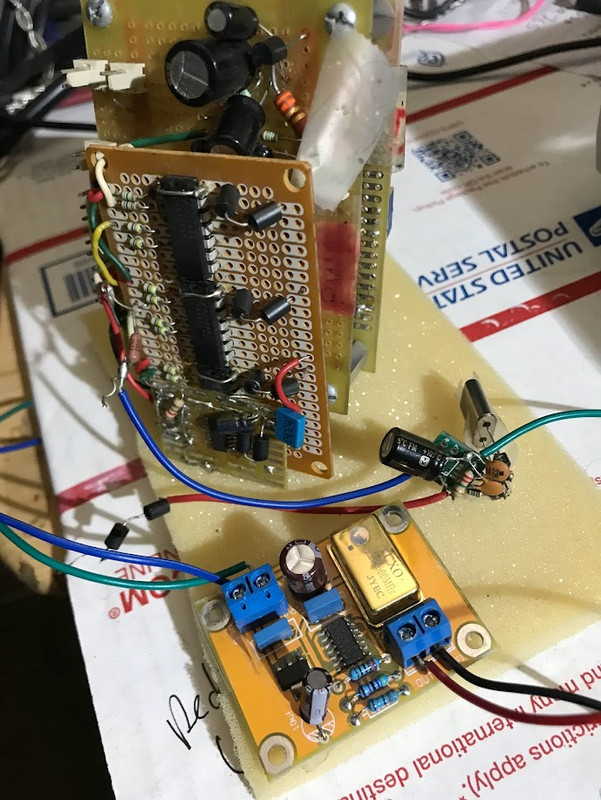

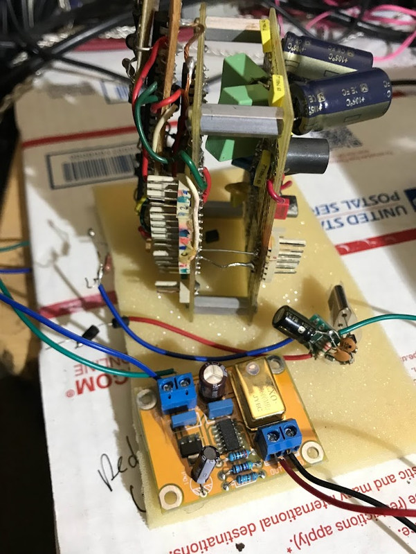

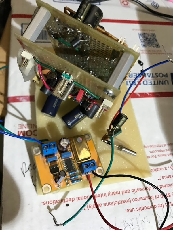

Say I have to measure several dozen 2-pin xtal cans, 4.00 Mhz to 80.00 Mhz. They need to be checked for accuracy. All are hot-swappable in a 5v based DIY driver ckt. (see photo). This works very well.
But where I run into weird issues is when the same xtal is in the ckt they are intended to be used. Say an audio D/A, DVD player or CD player. Measurement  in situ , with xtal across an IC's X_in to X_out "driver pins" gives all sorts of distorted or inaccurate readings; perhaps, only the old Tek 465 is most reliable and repeatable for xtals in circuit.
What I have to measure:

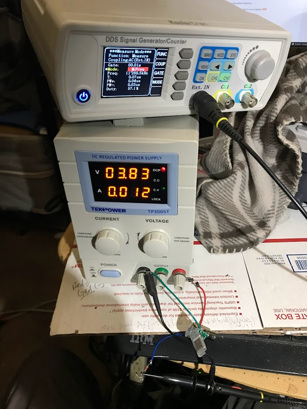

I have an old-school but calibrated Tek 465, a modern Siglent 1202x-e dso, NanoVNA, NanaoSA, Owon xdm2041 desktop dmm, and Koolertron DDS sig gen/counter.
Does anyone have preferences?
Test jig:
Works well even with simple DDS counter:

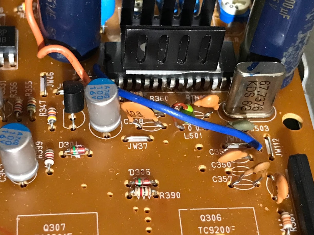

But here's where I run into issues (e.g., measuring in circuit, with xtal driven by microprocessor's X_in/X_out pins. I get no or garbage readings when probing at X_in or X_out -- with dso, dds, dmm, NanoSA, etc):
[/url

When measuring crystal oscillator circuits in situ, it's extremely easy to disrupt its operation merely by the stray capacitance from directly connecting your probe.
In other words, do not directly connect your probe to the Xtal oscillator, use a small antenna loop (use Dave's trick of connecting the probe alligator back to the probe tip).
