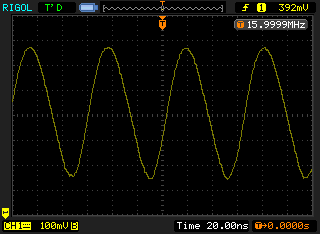

Offline equinoxefr
  • Posts: 6
Re: Re: Re: changing the rigol DS1052E to DS1102E using USB , the dummy guide
« Reply #1184 on: January 18, 2013, 05:37:52 am »
Hi, I did the same process but i didn't lose calibration. I tried with various signals, also with the crystal in the arduino without problems (screenshot attached).
Hummm is your trigger level at 0?
change your timebase to 5ns and you may see a little delay in triggering. On my scope I had 0.5 div of delay with 5ns timebase in real time mode. You can check my screenshot.
Not dramatic but...
You can also check it with :INFO:EQUTRIGDELAY? And :INFO:REALTRIGDELAY? Command. On my scope I had a 0 value.
In this case, set values with
 :INFO:EQUTRIGDELAY -0.0000000028
 :INFO:REALTRIGDELAY 0.0000000034
If it doesn't work, ask Drieg for a little help ;-)
Pierre
Envoyé depuis mon Nexus 7 avec Tapatalk
