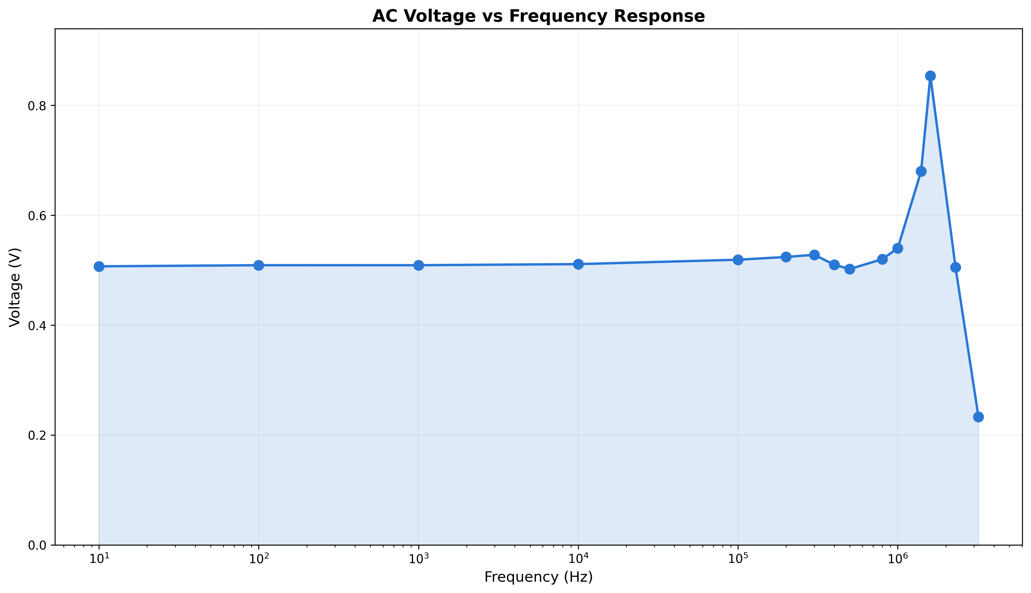

AC response 1V range ,  0.5V input,  modded 34401A
i use my basic analog gwinstek gen, so output may float a bit,
here # : ( 10Hz 0.507 , 100Hz 0.509 , 1Khz 0.509 , 10Khz 0.511, 100Khz 0.519, 200Khz 0.524, 300khz 0.528, 400khz 0.510, 500khz 0.502,800khz 0.520, 1Mhz 0.540, 1.4Mhz 0.680, 1.6Mhz 0.854,2.3Mhz 0.505, 3.2Mhz 0.233)
3.2M - limit for this gen.
1.6- a peak,  some kind resonance or something,
« Last Edit: September 06, 2026, 11:36:38 pm by GigaJoe »
