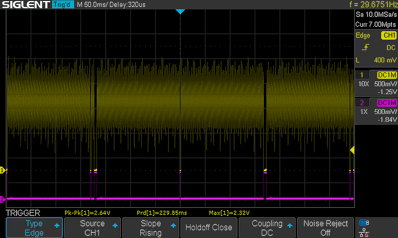

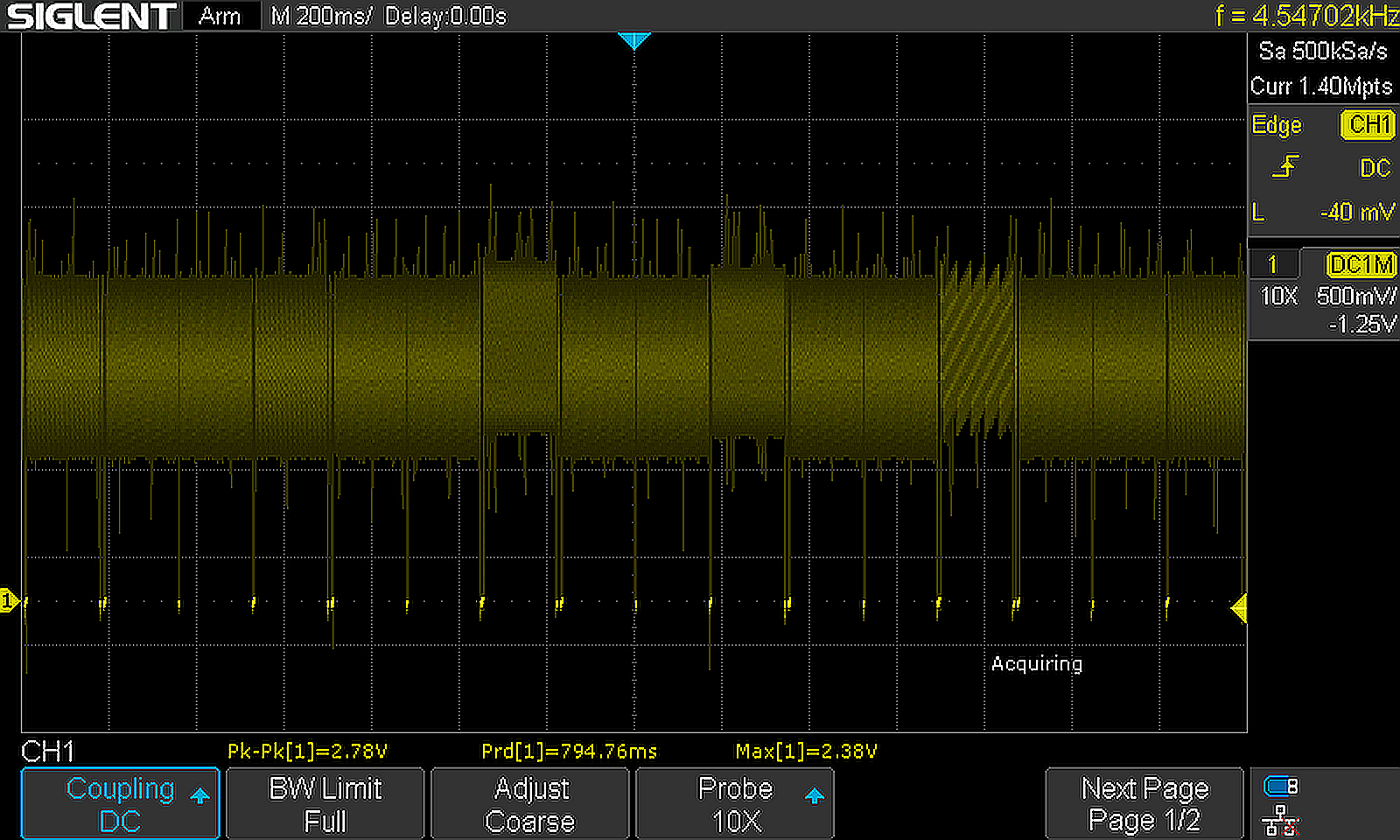

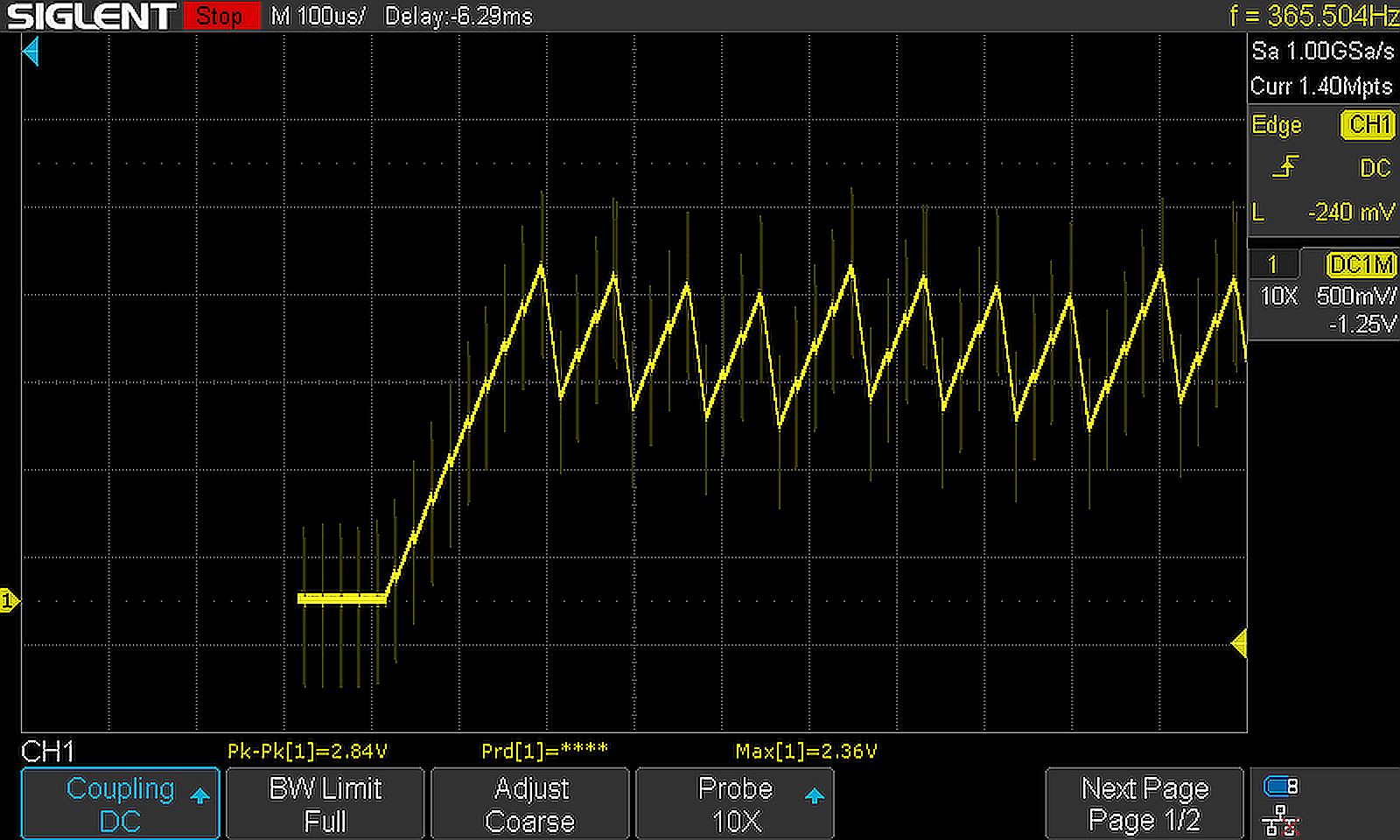

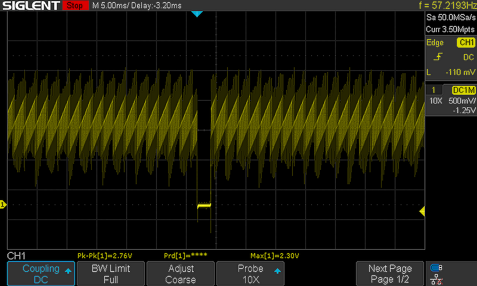

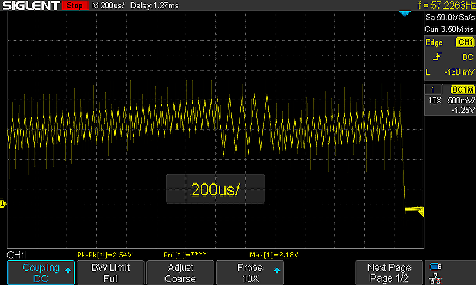

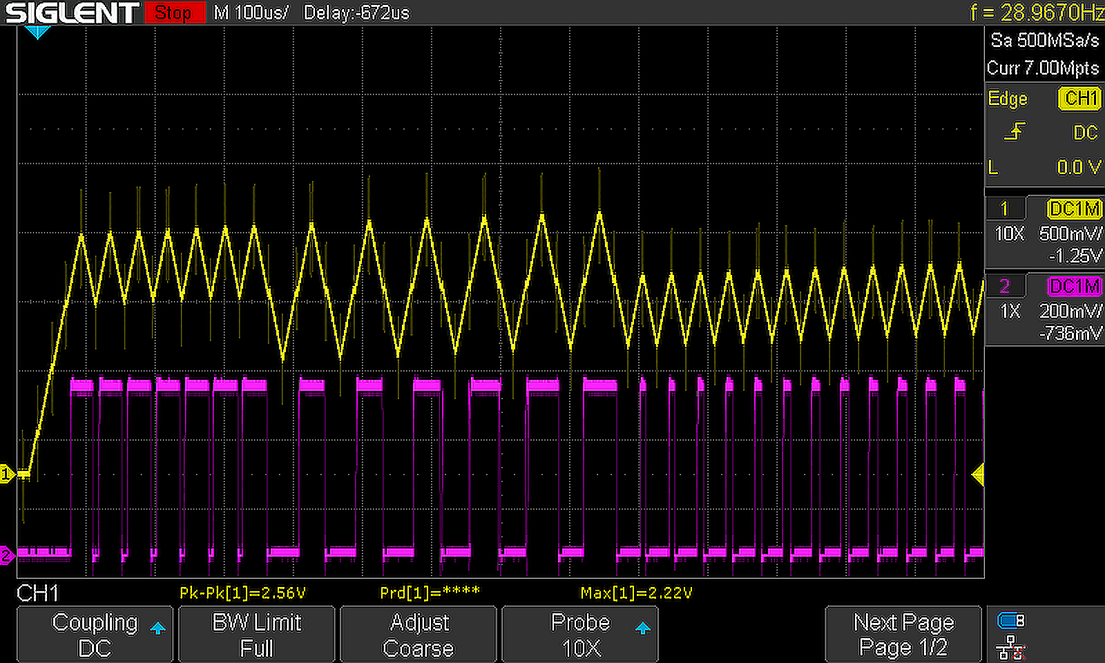

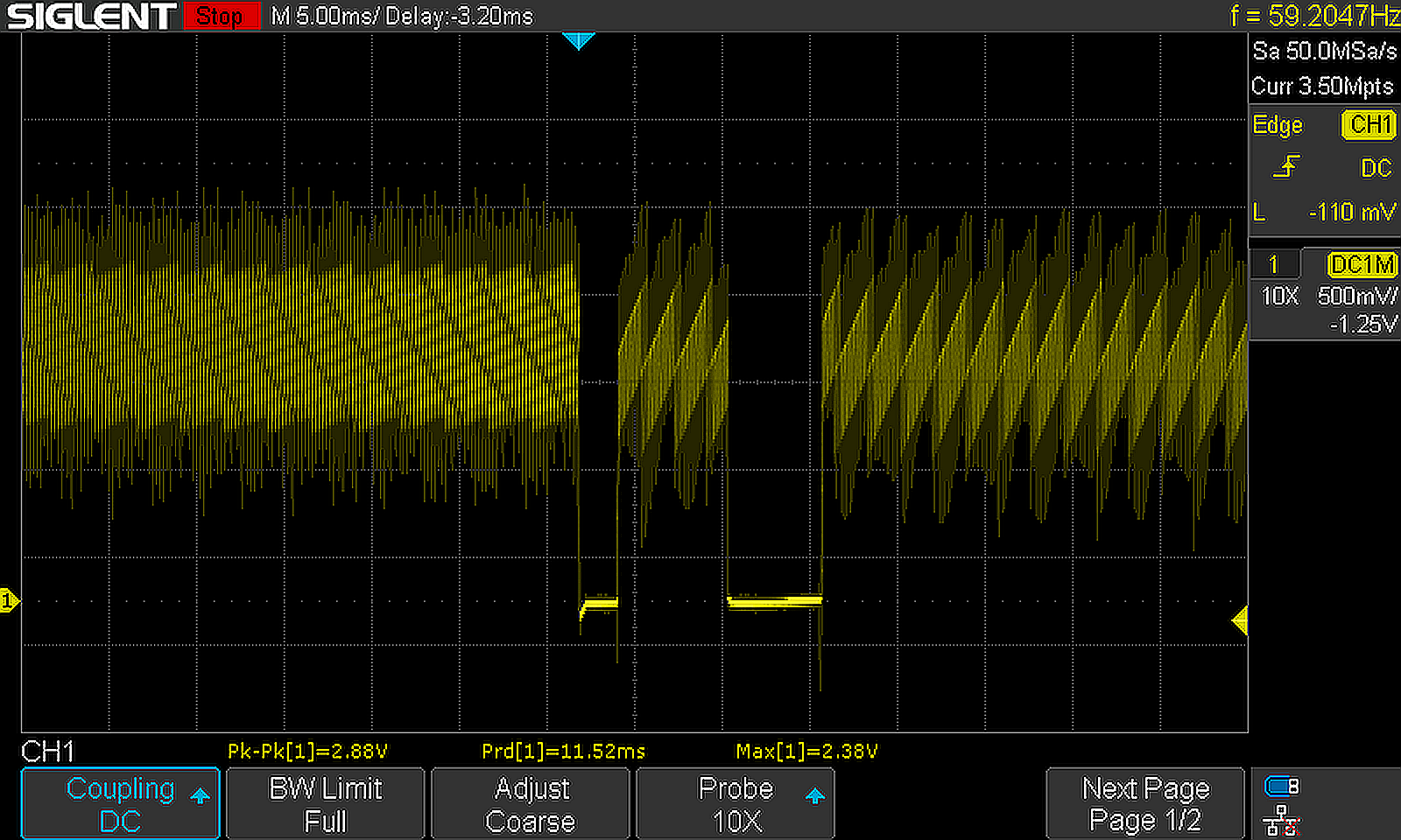

Here is integrator output , opamp pin6 - Cap. , this is single opamp version, current opamp now OPA189 :
some thingi not understandable for me, so let's go:
Set:  range 20V, 10PLC , input short.
(bit enchanted pictures .. )
Basically in sequence it measure something , like input , 7V ref,  short,  and here is sequence.
Bottom marks is when integrated cap. shorted
P00: https://i.ibb.co/b5pmxHrS/00.png
shorted long time, we measure something differ:
P02: https://i.ibb.co/fzg84Xrt/02.png
or short time, measure the same:
P04: https://i.ibb.co/fY5Q8X20/04.png
or twice:
P06: https://i.ibb.co/93ShkC8M/06.png
Hope someone may comment better ...
not clear why it measure like this:
P08: https://i.ibb.co/kLXwNm5/08.png
or like that:
P09: https://i.ibb.co/m5kK2zNS/09.png
P09 - probably scope picking noise , that 5 spikes  on horizontal line, but it correlated to steps ( why this steps ? ) on rising edge, and not exist on falling edge. - about 160kHz , and do not exist in certain time, so maybe it not a noise ..  bottom flat line P02

« Reply #138 on: August 02, 2026, 07:36:24 am »
The rather complex sequence in the 10 PLC AZ case is interesting. It look like there are 2 different zero readings. Also looks like 10 PLC for the actual input and 5 PLC for the Zeros and 7 V ref.
The pattern in P8 is relatively easy to explain. One can get zero from alternating positive and negative. This what happens most of the time and gives the higher frequency. In the center one has a pattern with 2 steps positive and 2 steps negative which also give zero, just with a lower frequecy. This can happen from the delay of reading the comparator to switching the reference. Depending on the start charge one can transition to that pattern when ater 1 step the charge is close to zero. I see the same with my ADC and I don't consider it bad.
The short ripples in P9 with the rising slope part are the extra switching steps to get a fixed number of switch operations. They are missing for the down part, as the down part is only one modulation step long. So switching is before and after the falling slope. With the opposite sign input voltage one would see the extra steps with the falling part, but not the riging part.
The sharp 500 mV spikes up and down are likely from probing or the ground. At least there should not be such spikes are the integrator. The switching part can cause some issues with digital ground current and this way it can make a difference where the probe ground is connected.
These short peaks are sometimes picked up in the first picture and sometimes not, as a kind of aliasing / undersampling.

here is something 205 output ..
I tellin right away, it in edge of sense , board upside-down , and diff to reach, ground non ideal as well
time of exact measure - unknown , just random shots ,  probe x1 (for x10 - nothing ) , and a single, otherwise it just mess ..
https://limewire.com/d/AOS1i#Tq9qNQSRpq

The OPA205 output shows much of the expected signal. The square wave with some extra wiggles as expected for the run-up. There are however quite some extra spikes. This makes it messy. I don't think the extra spikes are all from poor probing as they are at odd / random times. So the meter may have an issue with a not so clean supply or the decoupling.
