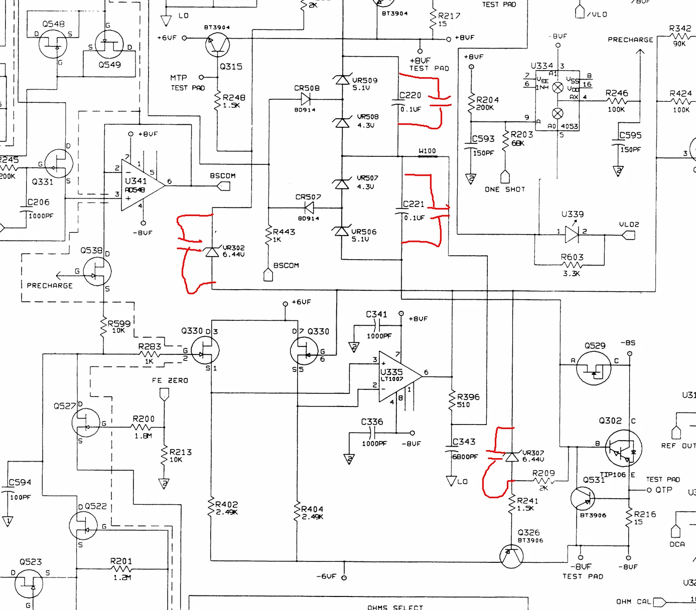

The idea of a boostrapped supply workes nice for the CMRR with the input FETs and U341 (AD548). It's not infinite CMRR, but quite some improvement (e.g. 60 dB and a bit more for the JFETs). The PSRR should be good enough with U341 - but needs some care with zeners (some are pretty noisy).
The supplies for U341 and the JFETs are linked, which complicates the circuit quite a bit.
For linearity the cross over distortion of U341 might still be an issue. This might cause some a small step near zero in the 20 V range. It may however bit tricky to see error on the order of 1 µV in the 20 V range with all the noise.

" boostrapped supply workes nice "
not sure how nice it works , don't want to argue , but in my practice  that 4 caps drop down noise almost 3 times , especially nasty peaks up to 200 microvolts P-P ..   U341 as AD548 - never exist such type ,  one unit TL061 , other unit , not remember OP124 or something (but it was ANALOG) .
https://i.ibb.co/PZm01fD5/caps.webp
and many tantalum capacitor on the back board in parallel to bypass caps ...  that alone drop down noise to around 50 μV , and 10-12μV wobbling due to zener.
how it was:  https://www.eevblog.com/forum/metrology/k2001-adc/msg6084777/#msg6084777
After that was a second wave of opamp replacement , major U341  TL061 -> OPA140 ,  noise decreased a bit became more even .. , replacement LT1007 -> OPA189 - almost non measurable,   but couple μV there and there .. , of course zener adjustment eliminate waves and wandering ... , couple more caps :)
and last wave adc , itself a bit there and there :   LT1097 -> OPA188 , LM311 -> LM211 , NE5534 -> TL888 (OPA140) + ampl 5K -> 511 , and another resistor.  additional bypass caps, 5V that over divider generate reference voltage floor for comparators 680uF , of course couple for the digital part .. again few μV  there and there ..
and final most headache 1 opamp integrator to 2 opamps  second unit ADA4077 no divider  OPA1655. first still in progress  (second device more noisy btw ...)
that the story about ...
BTW,  replacement NE5534 -> OPA140 made some magic in noise that i can not reproduce, potentially, i assume,  that particular NE5534  wasn't good , it has to be fast as replace to ADA4077 made it RND generator.  for purists NE5534 ->SA5534A , i pick TL888 .

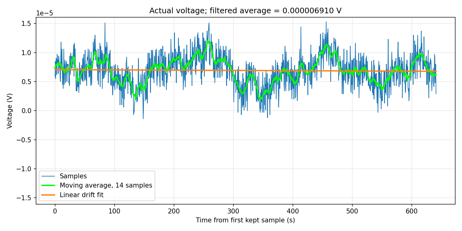

« Reply #178 on: September 17, 2026, 07:41:47 pm »
for dual:
ADA4077 + OPA1655  , kinda work , i think not optimal
for single:
OPA205A + OPA197 ;  ideal ... i think OPA205A + OPA1655  but i have difficulties to make it stable so OPA197
here last: so noise around 7-12µV  and wobbling , i give up ...
https://i.ibb.co/ns91Nqg3/voltage-actual-centered.png
so average x7 (NOT 10 ) give a quite reasonable output of few µV floating
ADC a fraction of whole thingi ,  before screw-up ADC ,  add capacitors for filters ( make sure it not start ringing )
replace U341 ( for 20v ramge)
adjust current to zener TC=0 on adc board.
may replace LT1007
and hook GPIB to get data for analyzing .... then try ADC ...

« Reply #186 on: September 21, 2026, 07:04:08 pm »
about fan ... it 8V to fan , not 12, when i pick lowest noise , it produce quite low airflow at 8V feed.   i'm not sure if it matter ...
i still have ghost insde,   shorted 20v
https://i.ibb.co/3m631hHS/voltage-actual-centered.png
