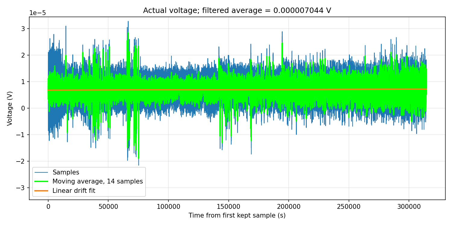

https://i.ibb.co/ns91Nqg3/voltage-actual-centered.png
so average x7 (NOT 10 ) give a quite reasonable output of few µV floating

about fan ... it 8V to fan , not 12, when i pick lowest noise , it produce quite low airflow at 8V feed.   i'm not sure if it matter ...
i still have ghost insde,   shorted 20v
https://i.ibb.co/3m631hHS/voltage-actual-centered.png
