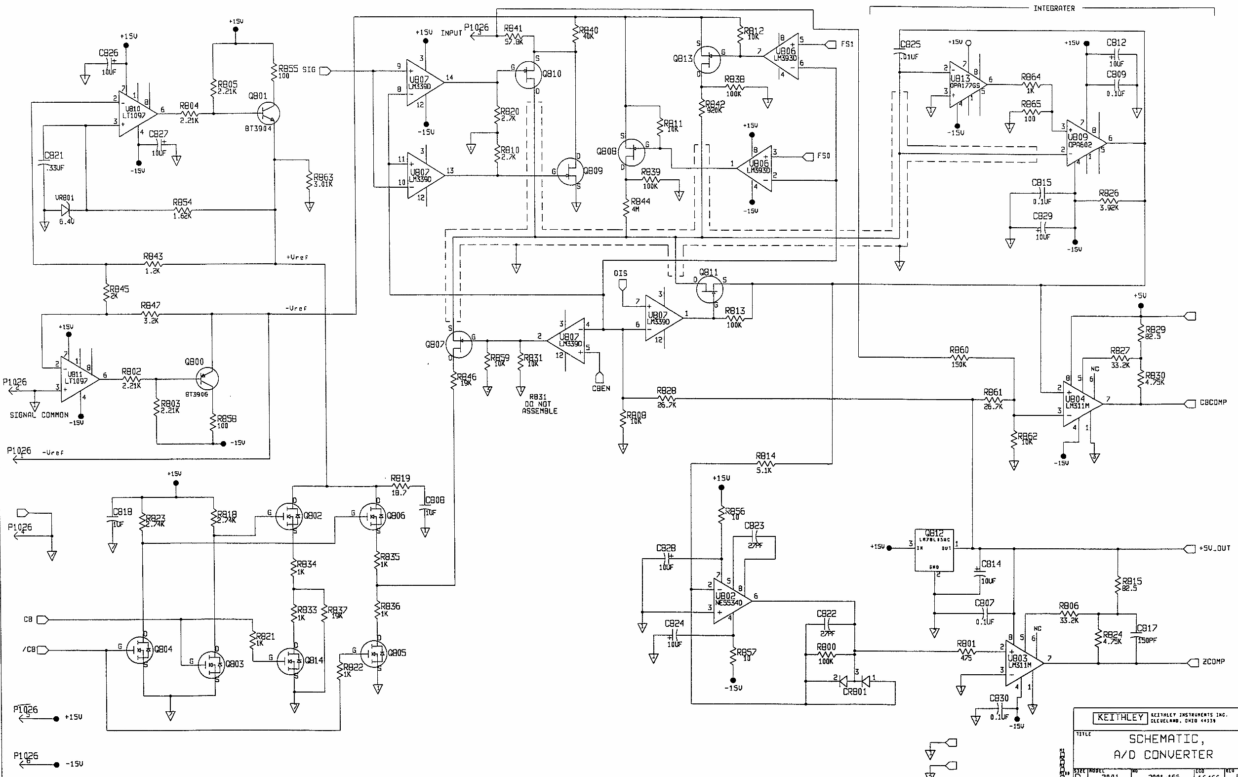

I have another question if someone can answer:
reference to the same schematic:
https://i.ibb.co/840yf0s1/ADC-K2001.png
left top corner ...  reference voltage source that generate suppose to very low noise +V , -V   voltage reference.
R805 ,  R803 - base transistors hook to positive and negative ±15 power ...
A - I don't understand why it there ...
B - it significantly decrease PSRR
so  i simulated to test, even ...  injecting 1V AC 1Khz  in power ±15 in a simulator - that give me 8mV P-P on positive and 16 mV  P-P  negative (definitely as it relative)
cut off both resistors:  +Vref - 3 mcV ...  -Vref - 7 mcV - noise .... ands DC decreased to 20 microvolts ( insignificant )
I think i should remove resistors  ...

« Reply #30 on: April 12, 2026, 12:17:55 am »
I think you better not, at least not without providing an alternative way to avoid an unwanted condition in the reference circuit - an accidental reversal of the output polarity and reverse biasing of BE junctions on Q800 and Q801.

« Reply #31 on: April 12, 2026, 06:46:04 am »
R805 also helps with start up of the reference. Without it, there could be a 2nd stable point with zero reference voltage. The offset of the OP-amp U810 could be enough to make it start the right way, but this would not work for a production run. How the power rails come up could also be enough.
One could get away with chaging the negative supply of U810 to GND (still tricky which ground to use).
The negative side should follow and would be less critical one.
The ramp / step of some 6 µV could come from popcorn noise of the K2001 LM399 reference. The LM399 commonly show popcorn noise in the form of 2 possible voltage values about 4 µV appart and jump roughly (still rather random) on the minute to hour rate. Scaled to 10 V thus would give some 6 µV.

somehow at morning an apt approach appearing, kind of brain behaving ..
that was with replacing NE5534 , now i got a second similar and significant flaw in ADC design ..
Q812 -  L7805   ( TO-92 , +5V regulator) , see link for schematics at the previous post:
I always look at as just a small voltage regulator to feed LM311 positive for adjusting TTL level ... right ?  wrong ...
it give a +5 rail for comparators.
it a reference for circuit to skewed comparators level , if output high or low  (3 resistors connected to pin-5 )
it a reference to trigger 3 comparators , ( see connection up to R861 and so )  , and follow up all this logic of triggering everything ....
it source of instability :
a bit warm up  and everything going up drastically
generate noise that cause a random triggering -   C814 , add 1000 uF -  you wouldn't believed how behavior changed ,   it  slowly up , and stay very calm just right after power up .... no any funky few hundreds microvolts jiggering ...
somehow need extremely stable +5V  ( LT1021 ish ),   and i have no idea where that "+5V_OUT" can be in use ....
one comparator - 5ma at positive   , so 10ma + something else ,   I assume 20-25 mA consumption ....
ANY  IDEAS WELCOME !!!!
( replace L78L05 , + it on edge of the board ,  - space tight )

« Reply #38 on: April 15, 2026, 04:19:50 pm »
According to the plan I have, the 5 V_out is a separate supply. It also supplies the FF (AC74) to sychronize the control signals. This could make the supply a bit noisy / EMI infested.
The voltage is also use to provide trigger levels to comparators, but these should not be critical (drivers for JFET control and comparator for run-up part).
A bad (e.g. too much ESR, dried out) C814 electrolytic capacitor could be an issue for the regular.
It may not be a question of the DC stablity but maybe high frequency ringing.

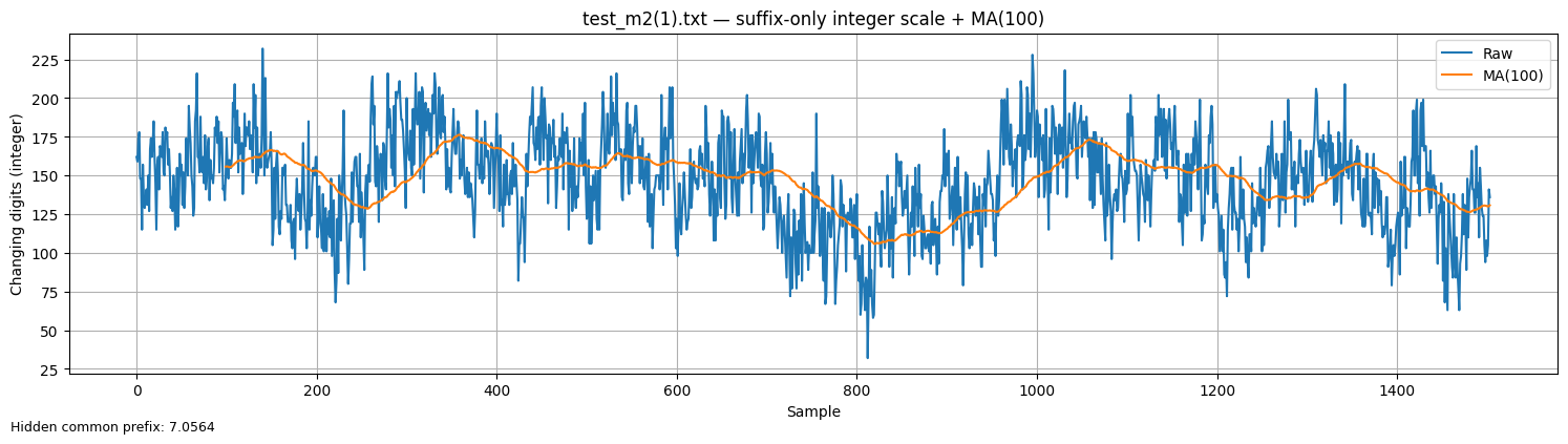

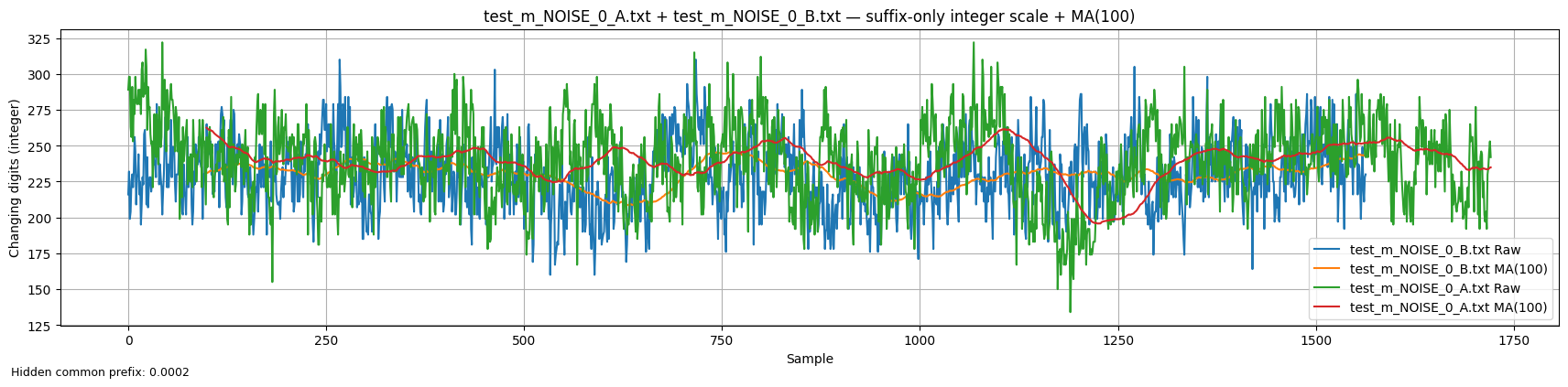

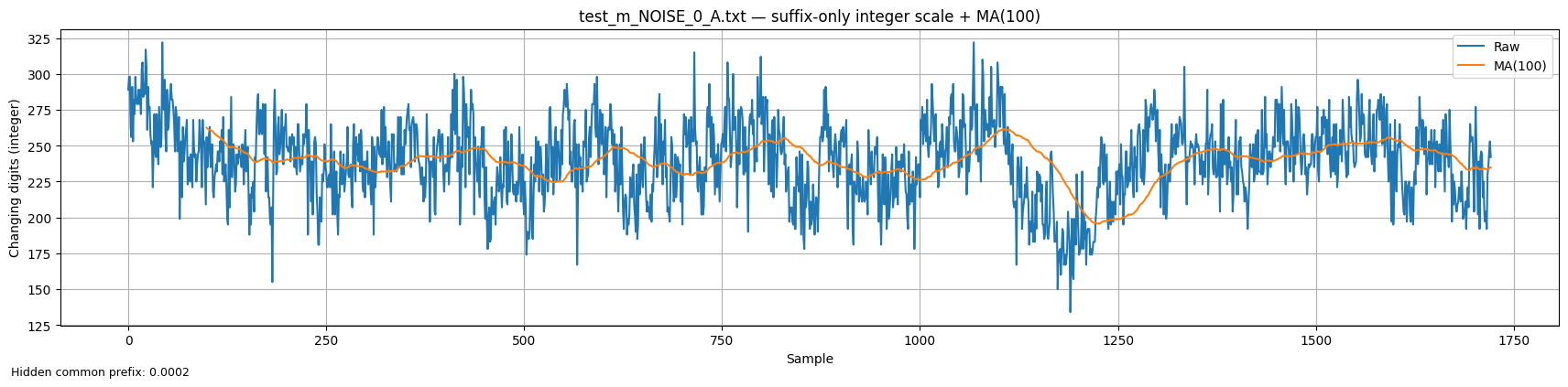

C814 - tantalum , i added 560uF polymer ...
so if i heat L78 up the output +5V decreasing down at 80 microvolts, and on display +7.XX V a bit increasing.
much more sensitive are set of resistors for comparator connected to Pin-5 , and JFET transistors - that really sensitive , especially Q808 , 9, 10
seem my jumping around L78 a bit overexcitedly  -  incorrect.
( but still better than before .. )
here is current status:
20V , 10NPLC , no any filter ,
vertical scale 10.0 microvolt , 100 - 10.0µV  , 150 - 15.0µV
I visualize 20K measurements , it 20K pixels wide PNG:
https://limewire.com/d/vgSLw#nyDosaPeRq
seems it maximum that possible to squeeze from this device, it still x20 better as it was before
mostly, i think, it a processing software, all this waves remind me an oscillating process to find equilibrium ... ; even such artefacts like below:
87474 +7.0564125E+00NVDC,   +12115.014430secs, +23065rdng#, 00extchan

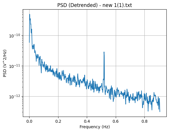

Offline Kleinstein
  • Posts: 17202
Re: K2001 ADC
« Reply #40 on: April 16, 2026, 07:13:31 am »
When measuring something like 7 V, there can still be quite some noise from the meters reference. This still just a LM399, that ususally come with popcorn noise (e.g. 2 values some 4 µV apart).  The low noise zener at the ADC and digital low pass filtering (the not so well understood software in the background) would still leave some waveiness with some 4 µV amplitude. That could explain much of the variations in the orange curve.
Even though the LM399 reference is likely selected and pre-aged, it may make sense to change the reference to a ADR1399, with the small extra changes needed (more current and 5 ohm 1 µF or similar snubber). After all the LM399 ref. is limiting for a 7 digit meter.
To test just the ADC part, a short at the input is the better test case. To keep things easy to compare I would stick to 10 PLC and no filtering.
Q808 and Q809 should not be that sensitive. Q810 and Q807 should be the 2 that have some effect, but should still compensate to a large part if the temperature is the same.  The AZ cycle that includes a measurement of the 7 V ref. should be very good in correcting slow variations.

idea: disconnect the junction R828*R861 (call it junction "A")  from the output of Q812. connect "A" via trimpot to emitter of Q108. adjust trimpot to give 5.xx V at "A". if that works, replace trimpot w/ resistor divider.

20V range ,  10NPLC ,no filter:  ( seems the same as with 7V )

The noise in the shorted case is indeed not much lower. At times there is still quite some low frequency noise. It is know that most Keithey meters show such off extra low frequency noise even in AZ mode. In the Allan deviation curve one can see this as the kind of plateau from some 1 -100  seconds.
The short time noise is OK, but that extra LF noise really hurts. The "Period" of some 100-150 seconds could be something thermal, but could also by on the timescale where LM399 popcorn noise happens or the ADC gain is averaged.
Some other investigations (https://www.eevblog.com/forum/metrology/dmm-adc-noise-comparison-testing-project/msg1366061/#msg1366061) showed that triggering could make a difference and part of the LF noise could be from the way the AZ loop is doing averaging.
It makes sense to use longer time averaging for the ADC gain / the 7 V ref. measurement step. This gives some digital low pass filtering for the LM399 reference, a way to fight LF noise there. However for the simple ADC and amplifier offset averaging over a longer time is not that good. It reduces the short time noise of the zero reading, but it lower the effective chopping frequency and this way lets more 1/f noise through.
1/f noise can come from many sources (input amplifier / buffer, the OP-amp at the integrator, the inverter part of the reference amplification (U811) and also the from excess noise in resistors). The highest noise gain (look like some 5.x)  would be from the precision amplifier in the integrator. On top of that there is the factor 2 from the input amplifier gain and the AZ mode taking the difference of 2 readings adds a factor of sqrt(2) for 2 readings. So referred to the input the integrator LF noise would be amplified some 15 times.
The OPA602 specs are some 0.95 µV_pp for the 0.1-10 Hz noise. The relevant frequency range could however be a bit different, but is a bit unclear with unknown extra averaging. With the noise gain this could be a good part of the observed noise.

The resistor to pin 5 of the LM311 comparator and the resistors around are likely there to create some hysteresis. They may also speed up things a little.
The extra capacitor C817 would make the hysteresis initially even larger and thus avoid ringing even more. For a slight speed up of the comparator one would also connect pin 6 to the positive supply.
On the downside C817 causes quite some current spike to the 5 V regulator - this could be some issue and why the extra capacitor at teh 5 V can help.
An alternative to C817 could be lowering R806 (e.g. 5 K range). This would give a larger hysteresist all the time and not just for a short time.
With an OPA140 at the integrator the integrator should be less of an issue.

another question:
integrator opamp U809:  R826 (3K) connecting output (pin6) to -15V
is it something for offset \ precise measurement ,  or safety resistor to minimize swing on positive side  , or inject -15V noise  ??

The resistor is likely there to make the integrator output stage run in class A mode. So avoid the output stage cross over and reduce the dependence of the GBW on the current.
If one is worried about the noise injected from the -15 V side, one could replace the resistor with a JFET constant current source ( ~ 2-4 mA).
Normally the -15 V should not be that noisy - if so check where the noise / interference comes from.

I added 470 uF in parallel to every tantalum 10uF  , 6 in total
0_A - before (green)
0_B - after (blue)
same 20V , 10 NPLC, no filter , shorted
standard deviation:
test_m_NOISE_0_A.txt:  2.716 × 10⁻⁶
test_m_NOISE_0_B.txt:  2.378 × 10⁻⁶
so i feed 20K lines to calculate Power Spectrum Distribution
that basically tell me nothing new , very slow drift and interference on the frequency of measurement cycle ...
Noise density ≈ 9.8 × 10⁻⁷ V/√Hz  = 0.98 µV/√Hz   , basically noise floor - 1 µV/√Hz
and this one:
some bins , missing , so some value as fraction of microvolts doesn't exist, like 0.000,220,1 ;  ,220,3 ; ,220,5; not really true 8.5 digit mode ... it also shows .. something , my thought not completely formed ...

It is a bit surprising that the extra 470 µF capacitors seems to help a little with low frequency noise. The frequencies are too low that it would have an effect as normal RC filter.  Maybe this is more a thermal effect with capacitors acting a thermal shield. If the extra LF noise is from thermal effects, it could also be just randomly more stable airflow.
The noise spectrum shows a peak at 0.5 Hz. With a sampling speed of 2 SPS this would be 4 readings period.
The other point noting is that the noise density goes up over the whole range. If the software doing the AZ mode is done right, the kind of chopping action (alternate between zero and the signal) should suppress 1/f noise quite well. I am afraid this is a firmware thing an nothing that is easy to fix. I doubt that Keithley would fix this for the very old meter - if lucky they might for new meters (e.g. DMM6500 , 7510, K2010) that seem to have the same issue.
Ideally they would add alternative AZ modes, without averaging for the zero and maybe also without the ref. step (more gain drift, but less noise).
One might get an idea of the ADC performance if this would be fixed by looking at the 10 PLC non AZ mode, take the difference of consecutive readings and calculate the RMS noise of this (like the 1st point of the Allan deviation). This would correspond to a simple HP like AZ mode.
The missing bins in the histogram are roughly equally spaced and there is no extra hight in the neighboring bin (like expected for DNL issues). So this should reflect the actual internal resolution. After all this is not a 8 digit meter but a 7 digit one (noise wise barely).
