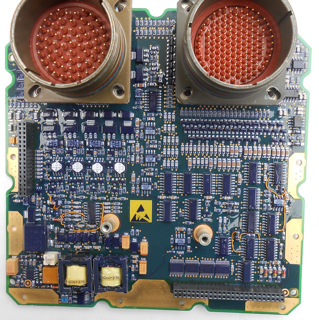

Here's some random commercial-aircraft electronics boxes that showed up for cheap as extremely-used or "for parts" on eBay and seemed worth a teardown, but didn't have enough reverse-engineering value or interesting signal-processing stuff inside for an entire post on their own...
Raytheon audio distribution bus boxes: full photos for Analog Interface Unit and Cabin Distribution Bus Repeater
These seem to be part of some kind of aircraft-wide audio distribution system, which is digital (!): the repeater has an FPGA and some LVDS transceivers (DS26C31, DS26C32) inside...
...while the "audio interface unit" has the same:
I'm guessing that the Analog Interface Unit takes voice or other audio signals and adds them to the bus, along with some kind of muxing/control.  Besides a buck converter in the lower-left for its built-in power supply (MAX758), the same signal passes through 2 separate DC-blocking caps to 2 separate ICs, the MT8870DS and MC14L5480.
The MT8870DS is a DTMF decoder, which suggests that there's some kind of telephone-dialing-style control which goes on through the audio input.  I'm guessing this has something to do with routing, where the cockpit of an airliner could do general broadcast audio vs. calling only staff at a specific location, for example.  I don't know enough about the context to make a better guess at this.
The MC14L5480 is an audio-specific ADC/DAC, which seems to be made specifically for voice as it has BPFs built in as well as companding, for telephone-style applications where bit-rate is at a premium.
The rest of the circuitry in the analog interface unit is centered around a bunch of op-amps and analog switches.  There's also a trimmer accessible through the top cover, which has a testpoint on the outside, and which seems to set a voltage directly on one of the connector pins.  I'm not sure exactly what's happening there, and the 4-layer layout makes it much harder to figure out the connections here (which is why this post doesn't have a full schematic yet), but would like to see what's going on with that trim - will have to take a couple sewing needles and poke around for continuity tests at some point when I have the time and patience.
I was pretty surprised that all the communications here was digital, even for the late-90's date codes on both these boards: seems like analog audio distribution would've been comparatively simple enough to have persisted up until the last 10 years or so.  Maybe there's enough sources of interference though with all the various electronic systems on a typical aircraft that it made sense far earlier to distribute voice in a more noise-tolerant way; at least the telecom industry has experience with doing that at an absolute minimum bit-rate.

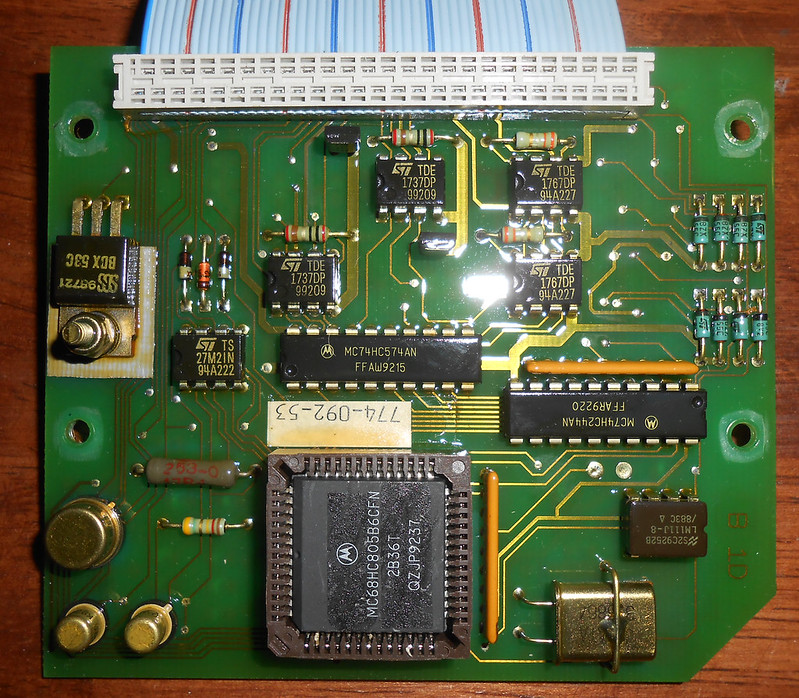

Diehl Fire Extinguisher Control Unit: full photos here
I was a bit disappointed by this one - had expected that something with such a critical-sounding function would have lots of redundancy and special reliability features: but no, it's pretty much just a processor with external inputs that controls some relays and external loads (probably solenoid valves).
The CPU board has a 68000-series processor, along with some TDE1373 and TDE1767 "lamp & relay drivers" - these have the normal set of protection features against over-temperature, short-circuit, etc. along with fault outputs so the CPU can watch for problems.  There's also a TS27M2 dual op-amp, which probably has something to do with temperature sensor inputs.
Haven't gotten around to tracing out the contents of these boards yet, but compared to the last ones they'll be much easier due to being only 2 layers and having no internal planes to get in the way:
The "power board" has a LOT of diodes: most of these, from my limited circuit-tracing so far, seem to be there to clamp the I/O pins to Vcc and ground.
There's also a few relays, two of which have their own drivers right next to them, which I'm guessing are for driving external valves to release water or foam.
Power comes in through the brown inductor, one of the spherical diodes, and into the big-ass capacitor (voltage hold-up during transients, especially those created by the load switching, is pretty important here I guess): the control supply then comes from the pre-regulator transistor (left side of the heatsink) which feeds only the 7805 +5V regulator (right side of the heatsink).
Figuring out if there's anything interesting going on with the op-amps on the CPU board is on my to-do list...

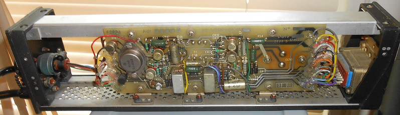

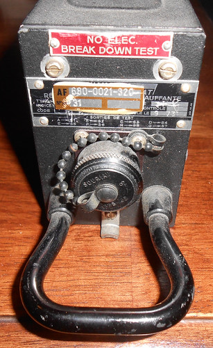

Electronique Aerospatiale/St. Chamond-Granat Windshield Temperature Regulator: full photos here
Here's a nice easily-traceable all-analog old one from the 70's:
The limiting factor here is not lack of circuitry or multi-layer boards, but just my own lack of time.
I'm curious to find out why what I'd expect to be a simple temperature controller needs 9 separate trims, or so many parts.  It does seem to have a good deal of self-test functionality built in...
...but it still seems like a lot.

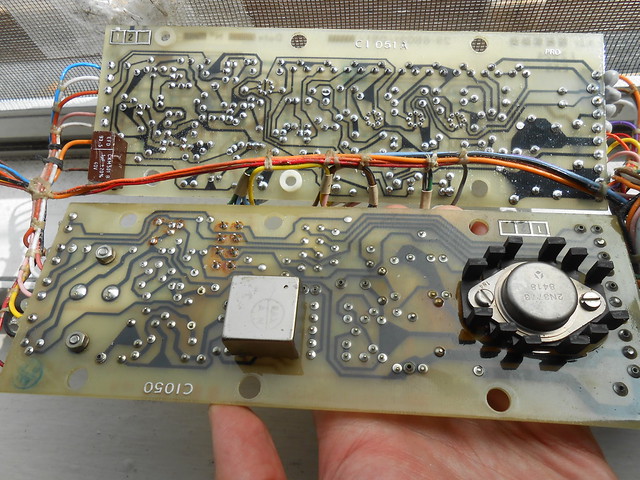

Looking at the backs of the boards, you can see the big transistor with a heatsink that most likely drives a heater, as well as discolored PCB material/conformal coating around it to show the record of high temperature over time:
Interestingly, both boards seem to be 3 layers, not using the bottom layer for anything outside of pads for the through-holes.  Maybe this is some measure to keep solder from wicking away from the joints before soldermask was common, or before soldermask was trusted in higher-reliability applications.
Looking forward to getting a free weekend to report back with a schematic on this one, and see exactly what it's using this seemingly-excessive number of metal cans for.
Small correction: That's a 68HC05, which is very different from 68k family. It's closer to the 8-bit 6800.

Very strange to see the PLCC 68HC805 socketed, that was generally a taboo for anything avionics. The protective coating seems to be mostly missing from the chip also, might have been a later repair.

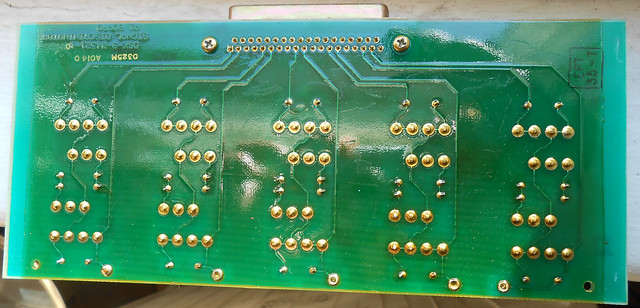

Once you remove a couple screws at the end, the case slides off and you can see the main board:
The circuitry is pretty straightforward.  A PCB-mounted transformer on the bottom, diodes on the top, and bulk capacitors on the bottom form the DC power supply from the 26 VAC input.  The large metal can is an LM126 dual tracking regulator, which likely generates bipolar power supplies for all the analog stuff.  An LM224 quad op-amp and a bunch of resistors probably take the analog sensor inputs and offset/scale them, before they go into the dual MC14433L ICs.  These are self-contained 3.5-digit BCD-output ADCs, the type you'd use to directly drive a display on a panel meter or something similar.
The BCD outputs of the MC14433Ls then go into a series of 4511 BCD-to-7-segment decoders...
...and from there, into the mess of wiring that connects the display board to the main board:
(I feel sorry for the tech who had to do these all day)
Haven't looked at the display board yet, but it's likely just plain 7-segment LEDs, since the 4511 can drive a good deal of current (25 mA or so) from its outputs, enough to get even the old inefficient LEDs pretty bright.
Might try and power up this indicator once I can cobble together some kind of janky 400 Hz AC source.  There's also a couple logic chips (4069 hex inverter, 4011 quad NAND gate) where I'm not quite sure yet what they're for: providing the "display update" clock, maybe missing signal detection along with a couple op-amps used as comparators?

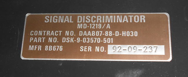

BAE Systems MD-1219/A Audio Signal Discriminator
This is a strange one.  The nameplate calls it a "Signal Discriminator", while looking up the part number at aerospace-stocking websites describes it as an "Audio Discriminator" and shows an NSN of 5821-01-248-4308, from 1987, with no specific end use outside of "avionics".  Ok, that's not very helpful, let's see what inside.

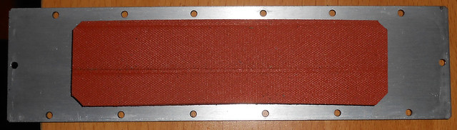

If you unscrew the back plate, you can see a piece of rubber that cushions the boards from the rear.  Unscrewing the front plate shows that the external D-sub connectors aren't directly soldered to the boards, but are intermediate adapters that plug into the boards' D-sub connectors.
There's two boards, labeled as "A1" and "A2", with no connections between them:
There's no active devices in the entire box: A1 has 5 channels of an all-passive circuit with transformers, caps, and diodes, and A2 has only relays and 8x-diode arrays in DIP packages:
A1 has 5 channels of a circuit which seems to mute signals under very roughly 100 mV amplitude, by stepping up the signal with an audio transformer, passing it through a diode, and then stepping it back down to its original level: I guess this could fit the definition of a discriminator if being generous?  Is this meant to mute the background noise from audio signals (from a radio for example) esp. if multiple audio sources are going to be mixed together?

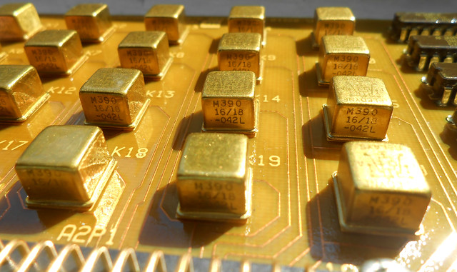

A2 is harder to figure out.  It has a 5 x 4 matrix of relays, with 5x channels (columns) where a common signal is optionally connected to any of 4 other individual places.  Because the traces run underneath the relays on the top side of the board I can't be 100% sure (ended up returning this box due to a lack of electronics inside, so can't do a continuity check), but it looks like this is a normally-closed connection.
The diode arrays then select sets of relay coils to activate, from some kind of open-collector drive, by switching the negative side of the coils.  (I didn't show it here due to laziness, but each relay has an internal catch diode on the coil which confirms the polarity)
Each of these activation inputs spans across all 5 channels, disconnecting an input on every channel but one.  There are also the vertically-arranged diode sets in the schematic, which seem to be some kind of diode-OR monitor outputs that go low if at least one of a specific relay-combo is activated.
This is obviously some small part of a much larger system, rather than a self-contained piece that can be understood on its own like a radar altimeter or a navigation computer.  Not knowing how this is supposed to be connected to everything else makes this much, much harder - I keep going through cycles of thinking that I might understand what the diode-and-relay combinations are doing, and then realize that I don't after all.  Any insights here appreciated.

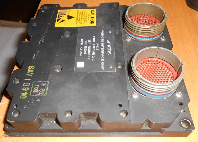

Smiths Remote Interface Unit
Here's a more modern one, from 2004, made by Smiths Aerospace.
My impression was that a "remote interface unit" was kind of like an I/O expander for an aircraft, and that seems to be born out by the internals.  Let's take a look:
There's a smaller control daughterboard, stuck on top of the main board.  Here's what the main board looks like, with the control board removed:
Off in one corner is the local power supply, with a UC2843 PWM controller, and a couple transformers and/or coupled inductors, which probably provide the low-voltage power for the onboard digital logic and analog:
The large black box towards the upper left is a capacitor (probably for buffering the input power rail).  The transistor (SOT-223 package) at the very bottom edge, below one of the magnetics, is probably the switching transistor.  The many diodes above the magnetics are probably the rectifiers for multiple low-voltage outputs.
Near one connector is what looks like a lot of switched-power outputs, with power transistors and 0.27Ω resistors for current sensing.  Not sure what the chips with the white labels on them are...maybe isolators of some kind? (if the "power-output ground" is different from the "control ground")  Or over-current protection / current-sense amps / gate drivers (if fast switching is needed for PWMing any of the power outputs) / all of the above?
If you look back at the power supply photo above, there's an analog mux ("HI9P548-9") between these power outputs and the power supply, which is probably used for selecting between the different output-current-sense signals, to measure one at a time.
There's possibly one more output channel just around the corner, plus some filtering (series inductor, white box) and protection (TVS diode(s) for over-voltage) for the power input:
...and possibly a couple more output channels in between the two connectors, although the current sense resistor looks different and one channel doesn't have a current sense resistor visible at all:
The other connector looks like it's all inputs.  There's a lot of series 56KΩ resistors, leading into dual diodes in SOT-23 packages, to clamp the input signal between the rails - see here for how this is probably arranged (I'm not 100% sure about these being dual diodes, but would bet a lot of money that's the case).  Between the large series resistance for current-limiting, and the clamping diodes, this serves to protect any input circuitry from the "wild west" situation that's happening on the aircraft wiring: lightning strikes, accidental shorts to high-voltage power, long wiring picking up high-power radar transmissions, etc.
The rows of many ceramic caps at the bottom of this photo are probably providing some basic filtering on these inputs.  The inputs seem to feed into a large group of analog muxes nearby (DG4xx series), which probably are cascaded in a tree-like configuration to select only one of these inputs at a time.
From counting the SOT-23 packages, I think there's roughly 43 external inputs, which requires a whole lot of muxing over a few hierarchical layers.  The 3x AD620 instrumentation amplifiers near the middle of the board (visible in some earlier photos) are probably providing some differential inputs, as a complement to all the single-ended analog inputs here.
There's also a bit of mystery analog circuitry around the side: maybe an output?  There's a DG413 (4x SPST analog switch), LM2903 (dual comparator), and 2x ST TS512AI dual precision op-amps.  There's also some colorful resistors which look similar to precision types from Vishay and KOA Speer I've used before.
This section might be scaling down a few higher voltages, buffering them, muxing between them with the analog switches, and then doing some kind of window-comparator function to check that they're within normal range (monitoring power supplies, for example).  Or who knows really, there's a thick layer of conformal coating over everything and most of the traces are on inner layers.
Ok, now that we've seen the switched (open-drain?) power outputs and muxed analog inputs on the main board, let's take a look at the control board.  What stands out most here is the pair of microcontrollers:
The large one is an ST10F269Z2Q3, a reasonably-powerful 16-bit part with some multiply-accumulate accelerators for signal processing(!!!) and a whole bunch of peripherals (PWM, ADC, timers, serial interfaces, an RTC, etc.).  The small one is a much smaller 8-bit PIC16F627.  I have no idea what the division of labor is between these two.
To one side are some local linear regulators, and two HI-8583s, which are dual ARINC 429 transceivers.  ARINC 429 is a commonly-used 2-wire serial bus on commercial aircraft, with similar use cases to MIL-STD-1553.  These transceivers include not just the level-shifting circuitry, but the serial encoding/decoding and FIFOs for storing received messages (or holding onto messages to transmit): they're meant to interface through a 16-bit processor bus, which is where the "external bus interface" of the ST10F269 probably comes in handy.
Covering the rest of the control board is an analog section (with many probable-op-amps and precision resistors, for proper scaling and offsets) leading into an AD977A 16-bit 200 ksps ADC.  This is probably what's reading all those external inputs one at a time, through the tree of analog muxes.  Even though the ST10F269 has an onboard ADC, the integrated ones are (intentionally) never going to be as good as a dedicated-purpose separate ADC, whether because of on-chip noise, IC process optimized for high-density digital instead of for high-performance analog, limited die area, lack of trimming, not wanting to sink money into an expensive high-quality ADC that many customers may never use on the general-purpose MCU, etc. etc.  I'm guessing the high sampling rate (impressive to maintain 16 bit resolution at 200 ksps!) is useful here when scanning between so many different inputs, if it needs to sample each individual input frequently.
So overall, this really does seem like the aircraft version of an I/O expander.  It's got serial interfaces to talk to higher-level computers on the plane, which can then tell it to turn on or off some outputs, and read back input values; probably offload some I/O processing as well.  The main MCU being so over-qualified for doing only basic communications and I/O suggests that it's also using its math capabilities to do some filtering or feedback loops or something similar.  This particular unit, being sold as surplus, supposedly came from a British Lynx helicopter.  Anyways, hope you enjoyed the photos.
