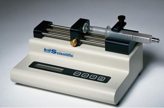

There are many models of syringe pumps on the market. I am not sure though if they are a good fit for accurate solder paste dispensing.
https://www.google.ca/search?q=syringe+pump&es_sm=119&source=lnms&tbm=isch&sa=X&ved=0CAcQ_AUoAWoVChMIlObkp8LZxwIVln6ICh3dmgA5

Agreed in spades. But... [perhaps only partly in jest] how about filling that tube with paste, and then instead of trying to push more through, you peel back the end to uncover however much solder you need.
That didn't seem like as daft an idea as I thought it would, so I wondered if you could create a sheath that would evaporate when heated to >150C or so (save having to peel it back as you feed it). And that led to me thinking that maybe if you could create some solid flux-like sheath it would be brilliant. And then I realised I'd just invented inside-out solder, so perhaps not :(
Solder Paste Sausage  :-DD

Sure.
I was initially focused just on the mechanical layout of what you had shown but the comments on the long tubing issues by KL27x are right on!  I would first try the tubing setup manually to see the problems yourself. I think you will find the bench with tubing idea to have too many negatives.  I can still sketch a improved mechanical layout but I think this is doomed with the long tubing idea.

Robenz, you have the know how and tools to offer great paste dispensers that don't require air compressor. Have you considered it?
Thanks for your confidence in me!  I have not thought about it because I have an air dispenser that works very well. That is a very good idea that I will put some thought into. :-+
