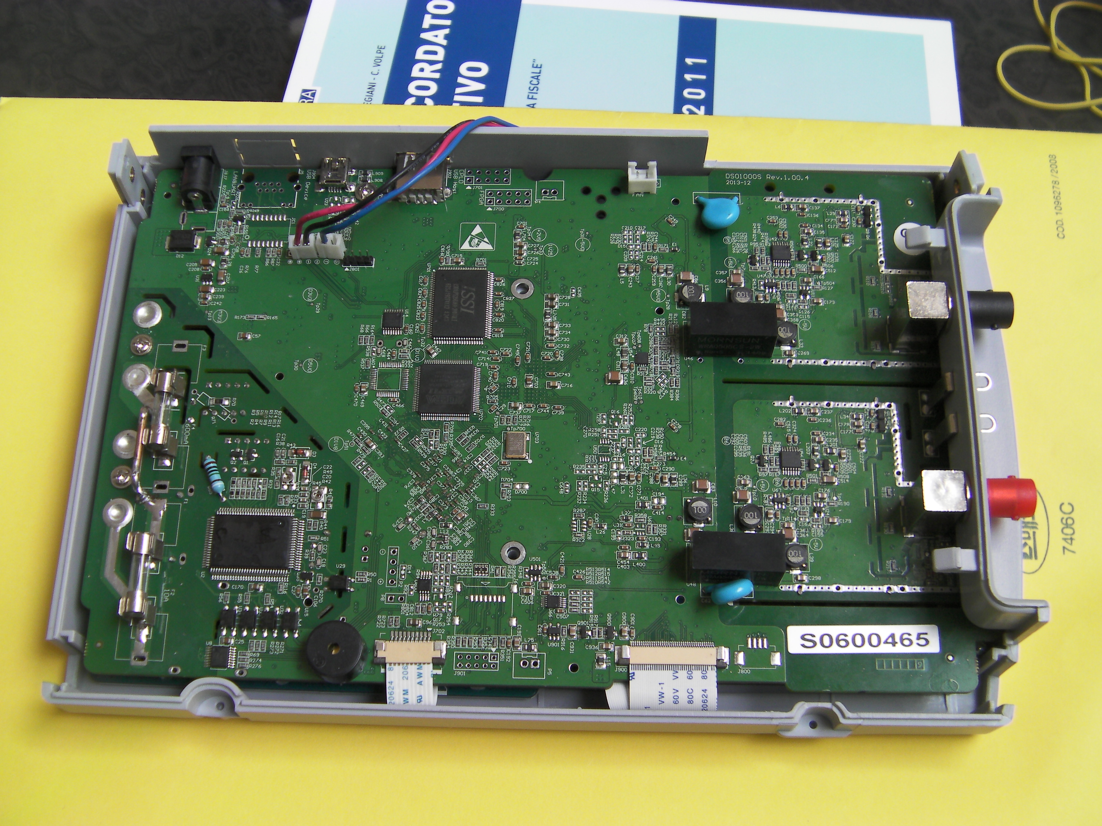

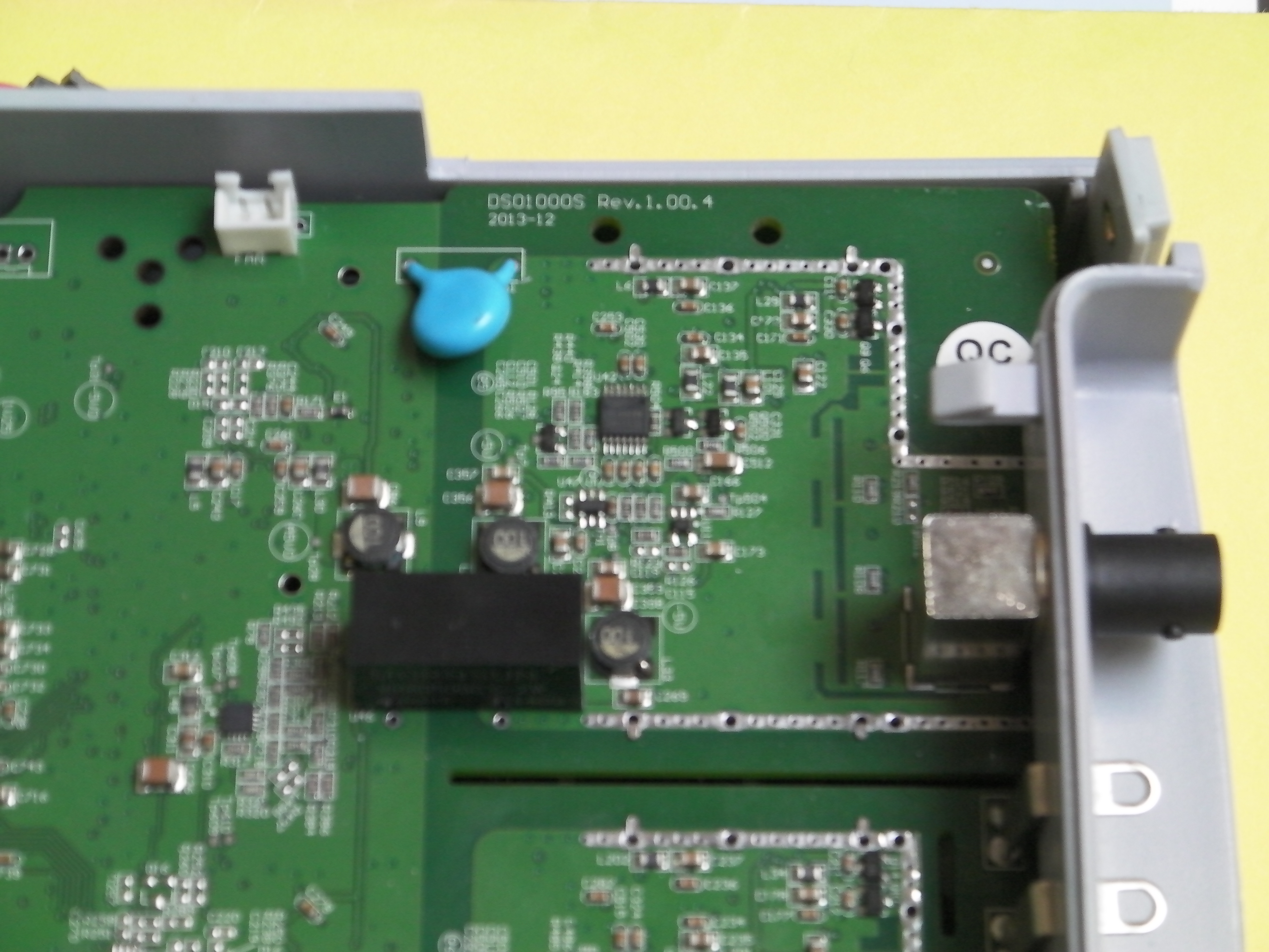

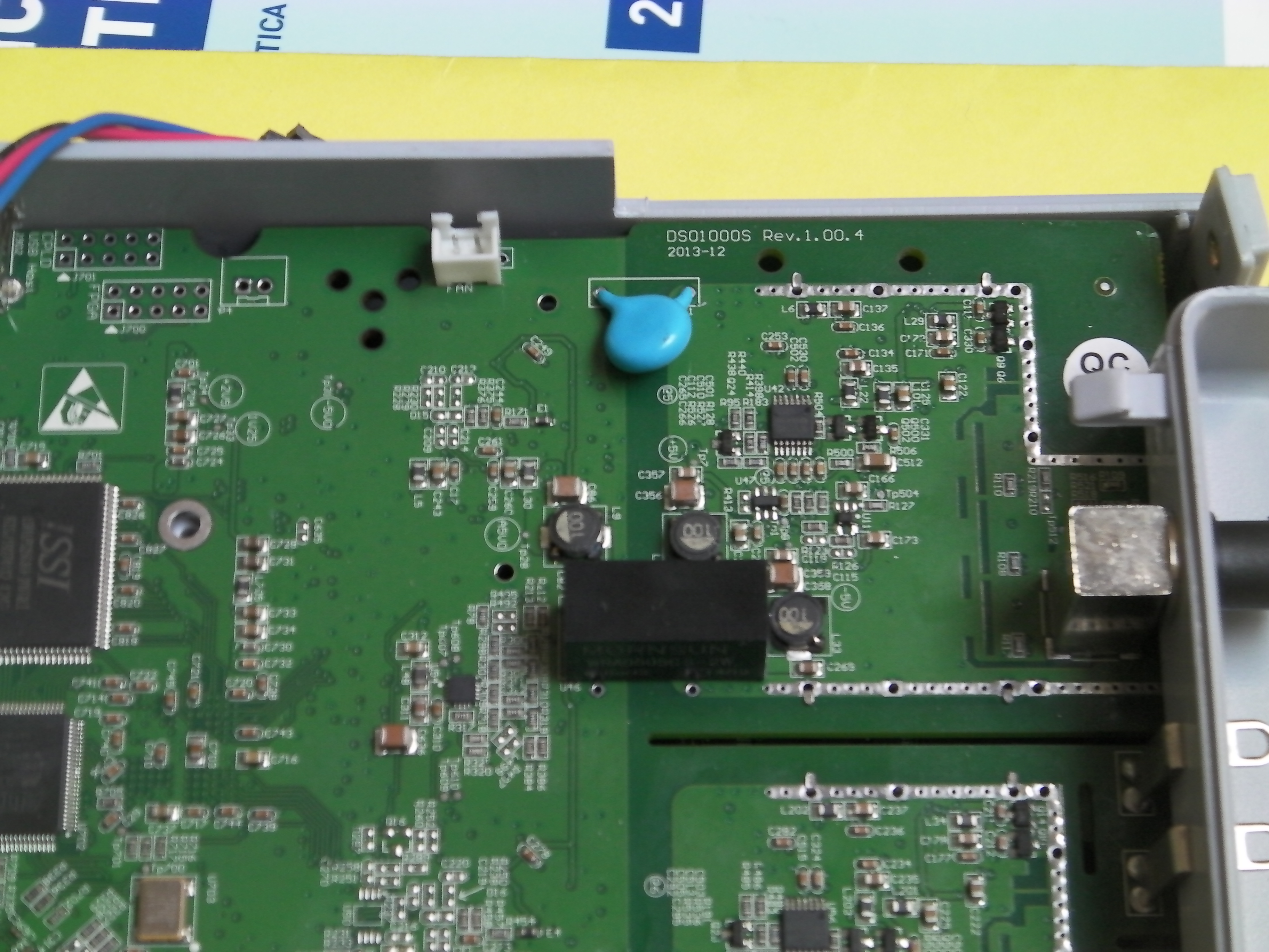

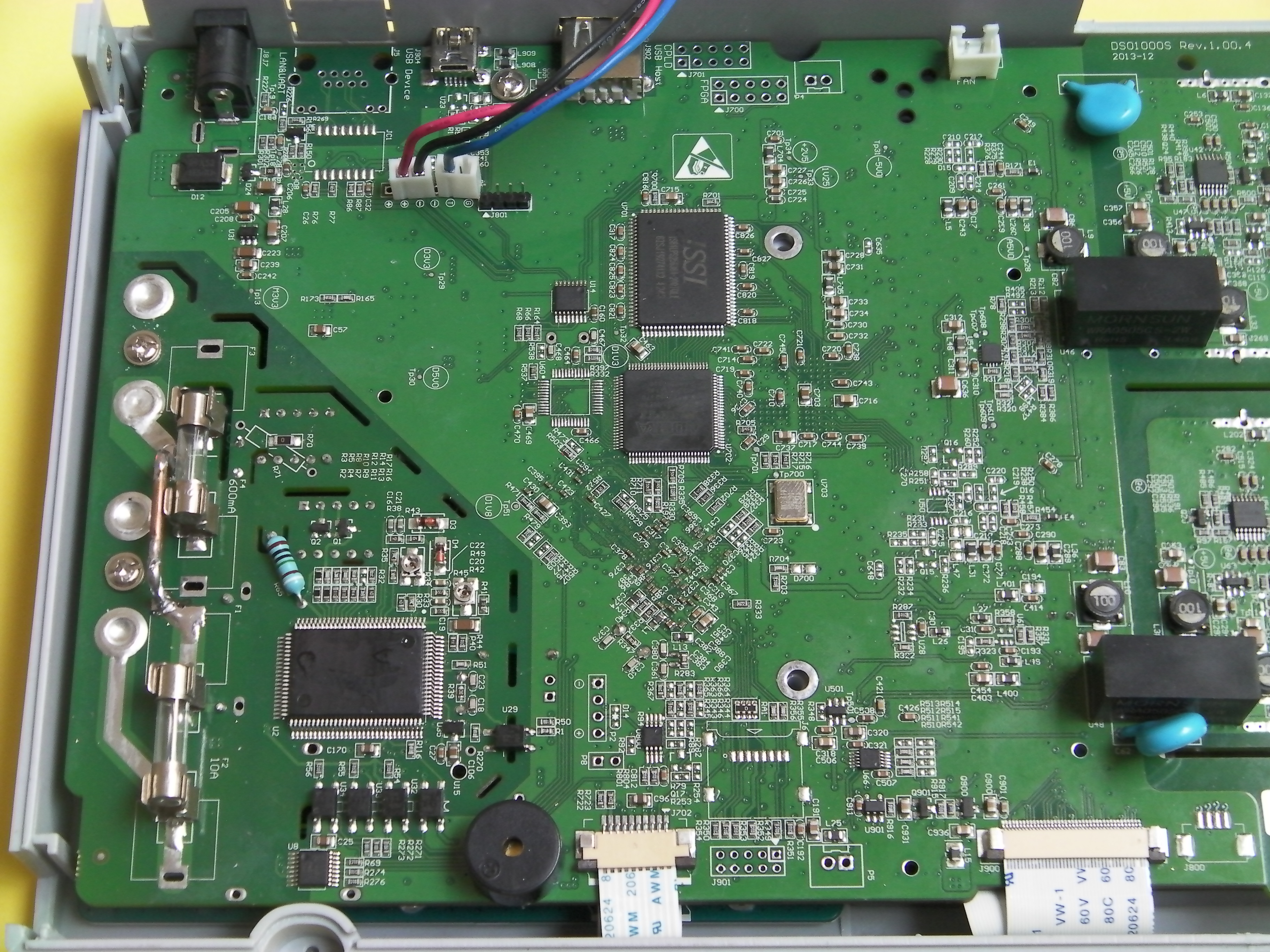

Here a few, not so good, photos of one side of the hantek dso1122s board:
the other side please as well :)
P.S. by the way I'm looking for the sd socket, have you got a suitable part number ( or farnel/mouser code )
digikey 101-00303-68 was good for non-s models, i think it does fit on yours as well

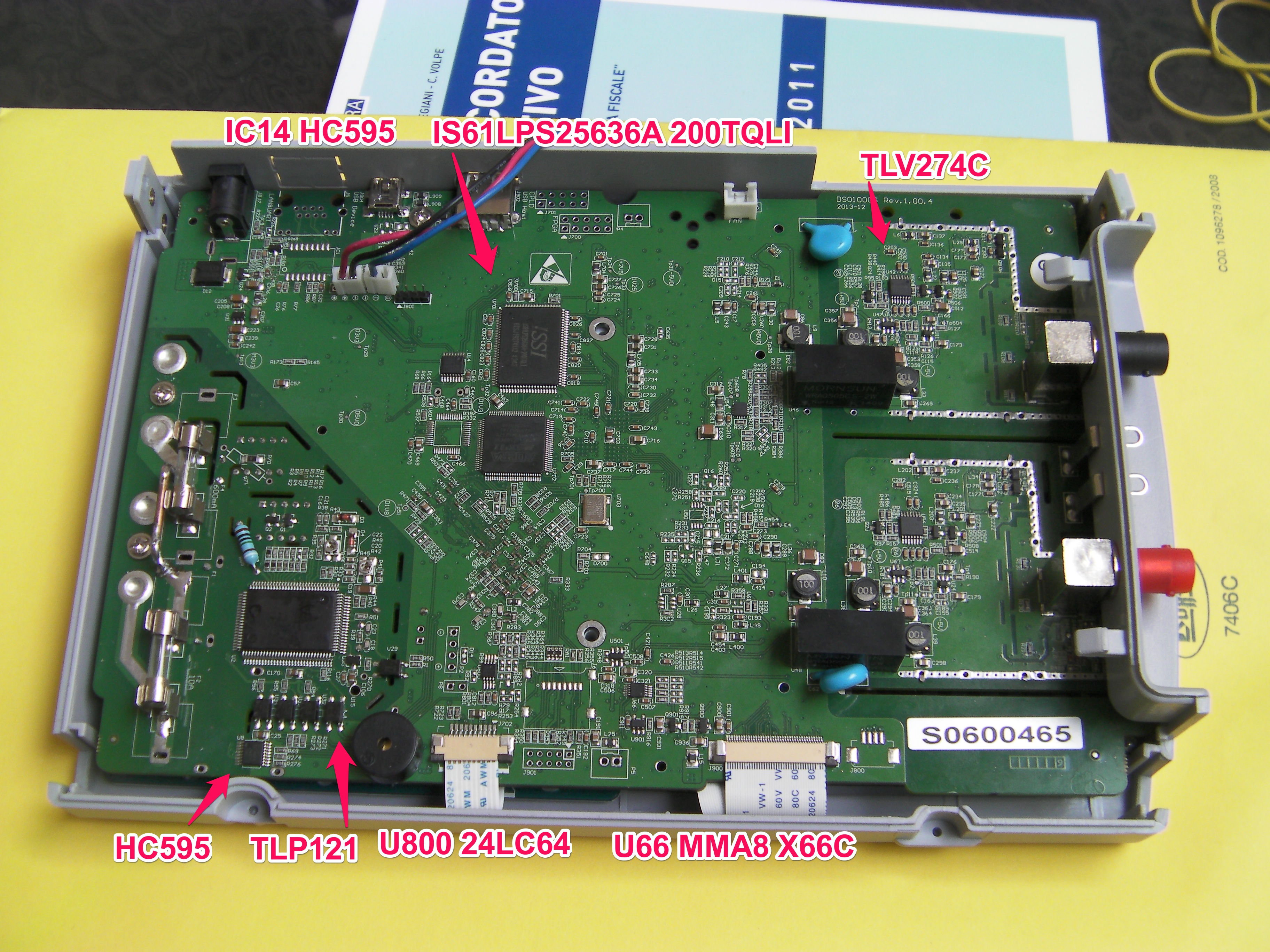

now when compared to dso1102b (hw1.01 with old SoC) one can see that they moved some parts to bottom side of PCB, i like that, it was before somehow overloaded. They improved a bit the distance and isolatin between DMM and DSO. One is however still bit strange, that one screew between two DMM terminals, they destroying the distance with that screw :\
Wondering why you got DSO with these small fuses, i had such fuses only on model for chinese market, on one for EU market Hantek used proper big fuses, see my pictures (do not wonder about the solder residues, i shot pictures middle of PCB repair/mod).
No idea if this is still the case, but gosch, on a wonderfull isolated DSO such fuses for DMM is bad ass thing, shame on them if that the "new EU version".
