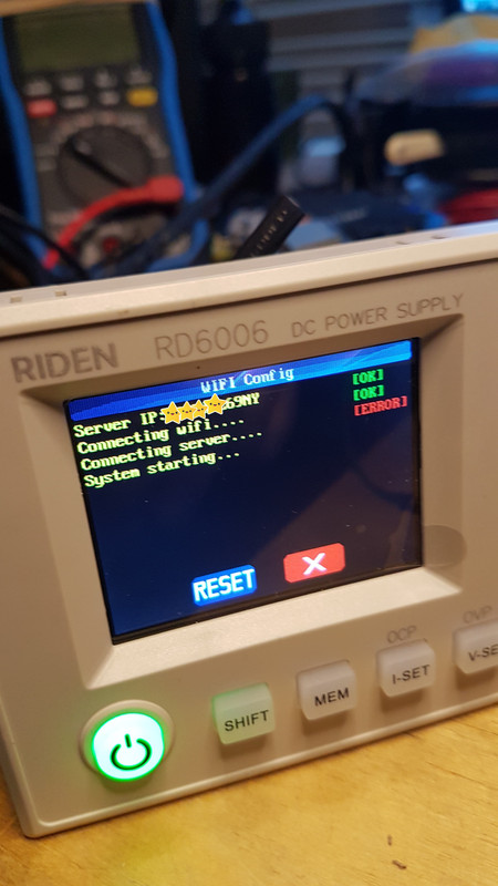

« Reply #361 on: October 14, 2020, 09:31:11 am »
Apologies if this has been answered elsewhere, WIFI selected, on power up my RD6006 displays a WIFI key for the Server IP: which I cannot for all the will change to an IP address. Just to note and thank UniSoft after flashing with his modified firmware no change to WIFI boot up I have removed the CR1220 and attempted to reset the RD6006 to defaults still no change. I can see Reset and X on boot up but cannot select Reset.
Any help, info in the right direction would be most appreciated.

« Reply #362 on: October 15, 2020, 05:37:00 am »
If you have this problem, as per FAQ, you should push initialize in the client (could be a handheld or a PC). If you doing that, effectively you will reset the configuration. At least that is what I do when I encounter such problem and usually it will work.

« Reply #363 on: October 15, 2020, 06:59:01 am »
I have removed the CR1220...
No need remove the battery, it will not help to reset settings...
settings stored in F-RAM (Nonvolatile Ferroelectric RAM).
Press "Left", then "ENTER"...
