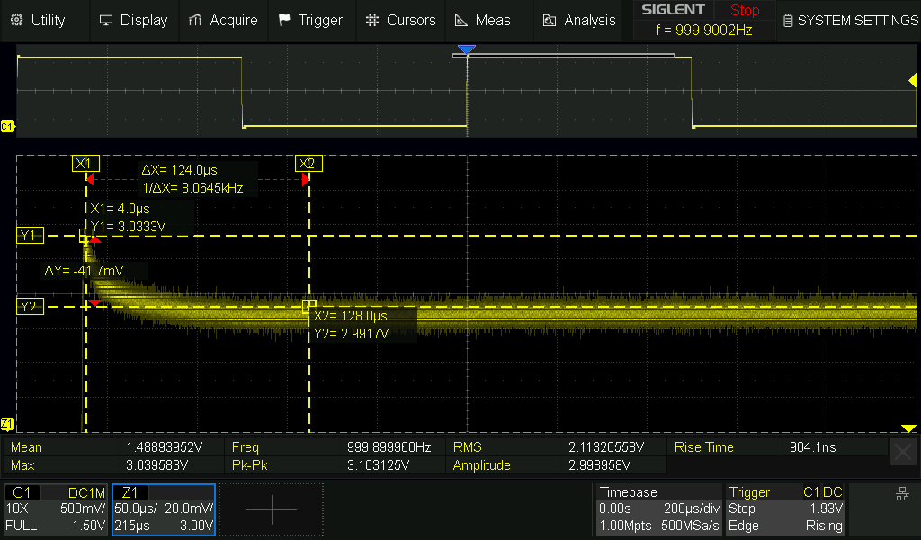

I have bought Testec MX-212 probes for the Siglent SDS800X HD and I realise I am not able to get a clean rising edge without overshoot when I compensate the probes. If I reduce the overshoot, the pulse is not flat anymore.
I noticed it from the beginning, but I thought it was due to the Siglent provided probes. I expected to get a better pulse response with the Testec probes but I see nothing changes.
Is this overshoot normal?
Am I doing it wrong?

Quite common to see when using vertical zoom.
Check the other channels too as the factory tuned step response might be better on the other channels.
Bit fiddly to change as it's normally done with an external source and the scope need be pulled apart to access the channel input trimmers.
I don't have that procedure for the SDS800X HD.

I used zoom because even not using it, it is possible to see a peak at the beginning the hight level.
Channel 2:
2942065-0
When I reduce the overshoot on the channel 2:
2942053-1
Channel 3:
2942057-2
Channel 4:
2942061-3
The behaviour of all channels is very close.
All the screeshots are made with the same probe, but with a different probe the result is quite the same.
« Last Edit: October 03, 2026, 08:57:15 pm by IC_Toaster »
A little overshoot is normal. I wouldn't expect a perfect square edge; adjust for what you think is the best/closest to a flat line.
The closest to a flat line is what I have made because the pulse is flat except for the overshoot. But I think that overshoot means high frecuencies will be amplified slightly

As Josh already pointed out, I wouldn't worry too much about it.
These overshoots are almost impossible to avoid and vary in severity depending on the probe.
For example, the probes I have here:
The Testec TT-HF612RA and LeCroy PP022—both excellent 500 MHz probes that aren’t exactly cheap—have the same impedance values (10 M and 10 pF). And yet, they behave differently when connected to the same input on my SDS3104X HD.
You can reduce the bandwidth to 20 MHz; this doesn't change the overshoot, which is also clearly visible when you use an external calibration signal—which, at less than 5 ns, is lightning-fast compared to the “sluggish” internal one—instead of the internal one. But it doesn't make any difference.
Of course, you could try out dozens of other probes until you find one that works best with the scope's inputs—but I think that's a waste of time, because there's something else to consider:
Probably not; besides, the probe itself throws a wrench in the works with its derating at higher frequencies—and it starts early on. ;)

Are these overshoots produced by the oscilloscope front-end or by the probe? With other probes I get also overshoot, but maybe with slightly diferent amplitude.
The overshoots you get are smaller than mine. To me, your oscilloscope-probe system works right, but as you said, your equipment is not exactly cheap.
Under my lack of knowledge I have not clear what is the souce of this overshoot that happens is all channels, but in spite of the probes are not expensive, I guess it doesn't depend on only the probes.

Do the Testec MX probes have separate trimmers for LF and HF compensation, or are those only available on the MF series (and better)?
MX has both trimmers.
I have adjusted only the LF one because, due to my lack of knowledge, I preferred not touch the HF adjustment. Moreover, I don't have a signal generator.
I thought of doing a cheap TDR, but I feel I don't have enough knowledge on high speed PCB design.
I think it's a combination of both.
I just tried two other scopes(Magnova BMO350 and Siglent SDS7404A-H12)with the Testec probe—so a total of three different scopes with the same probe—and didn't get three identical results, which, in my opinion, supports the “combination” explanation.
But again, I wouldn't worry about any potential drawbacks when taking measurements.

It's always a combination. Each probe is compensated per channel per scope (probe compensated for CH1 needs to be recompensated for CH4 etc.).
Maybe you can get better combination results having a lab compensate the scope front end and a probe for each channel at the same time...and the resulted difference probably won't matter. Except maybe superficially. ;)
It is so easy to fall into the rabbit hole of trivial precision.  In many fields.  What is the point of measuring to .001 microns when the bearing tolerance is .001 mm?  (Other than possibly production quality/process control).
