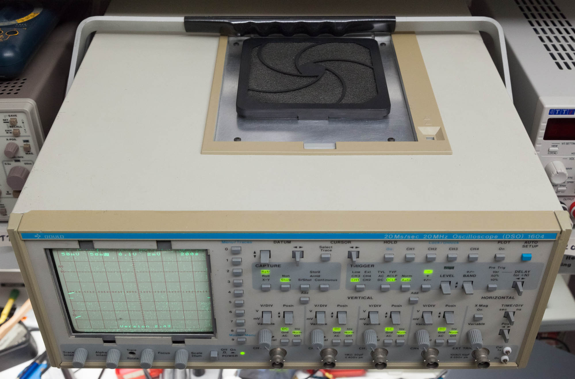

[...], Gould had a built in printer option, but I'm not sure if it was pen based or thermal, as I never used one.
I had a Gould 1604. It had a pen based printer on top. I never found the pens for this printer...
This scope was a bit drifty, depending on temperature. So I removed the useless printer, and replaced it with a slowly rotating 12cm fan:
This cured almost all of the drift.
Also, now I could reduce the speed of the original fan in the back. This made the scope almost silent.
regards, Gertjan.
Maybe the Gould 940 I had, had a pen plotter not a thermal printer. It's a long time since I had it and I never tried to use the printer, but the scope had a colour screen, so it's highly possible.

Ouch, Gertjan, it hurts to see the modification to that scope....
Wasn't it possible to somehow make your own pens for it? (from Bruynzeel fineliner pens for example) Shouldn't be too hard to bodge a pen, I'd expect? And nowadays, with 3D printers, the sky is the limit anyway.
If it had been my oscilloscope I'd have tried everything to make the printer operable again. Have never seen a scope with built-in printer myself. Would be pretty unique to have such a thing in the shop.

Hi nonius,
Even if the printer was functional, I would not use it. What use is a print on a cash register roll?
To use  it  in documentation, or show it on the web, I would have to photograph or scan it....
So why bother with the intermediate step of printing, instead of taking a photo of the screen directly?
On the other hand, the modification was very useful.
Before the modification, the scope was drifty. Focus, DC offset of the traces, and all kinds of settings where drifting. More so during the first hour. It was quite irritating while using the scope.
After the modification, the drifting was almost gone, and the scope was much more pleasant to use.
To ease your hurt, I did make the modification reversible. The alu plate with fan is mounted with the same four screws, as were used for mounting the original plotter.
I traced the root cause of the drifting to the drift of the ±12V power supplies. These were running rather hot. I managed to improve things with better components etc. But a real solution would need a complete redesign. Or better cooling.
A point in favour for the built-in plotter: I remember it had four coloured pens. While the screen was green only.
Fair enough, Gertjan :)
A thermal printer is indeed less useful but I understand that there are also variants with a small plotter. That'd be amazing to have in an oscilloscope, for me. But I have a soft spot for such technology where mechanical engineering and electronics are combined.
