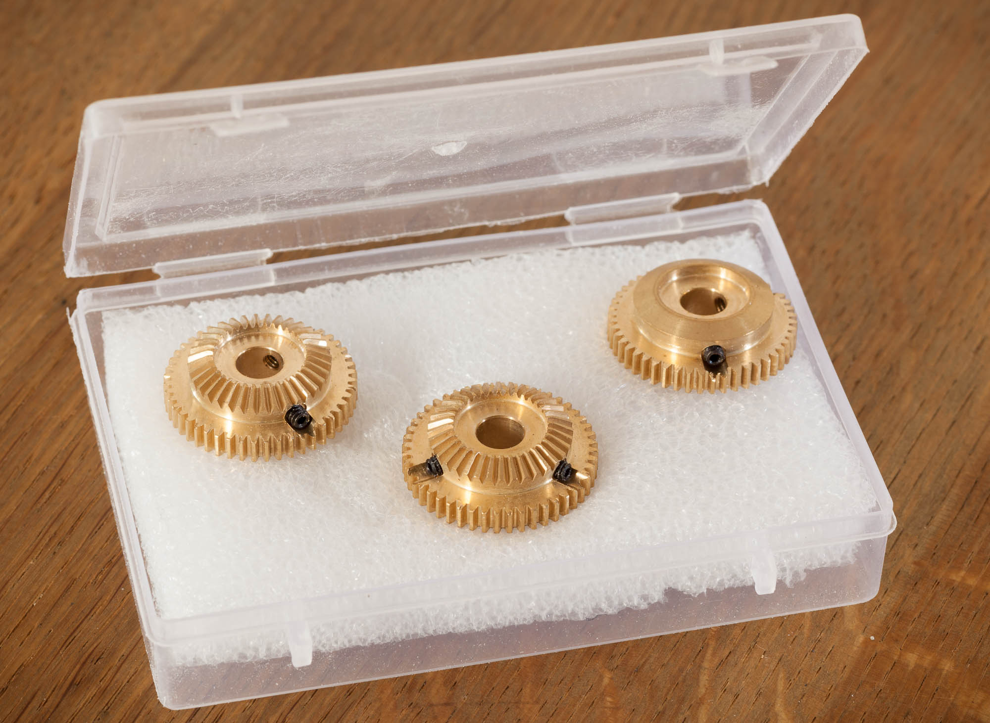

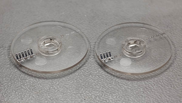

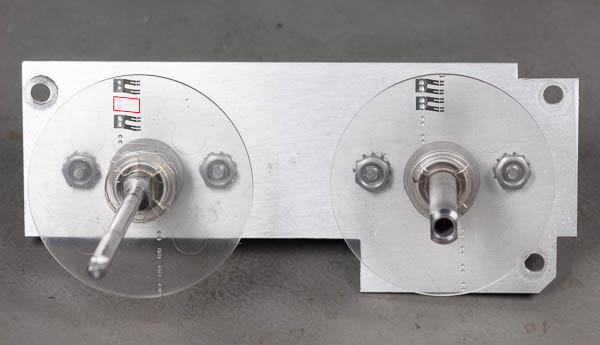

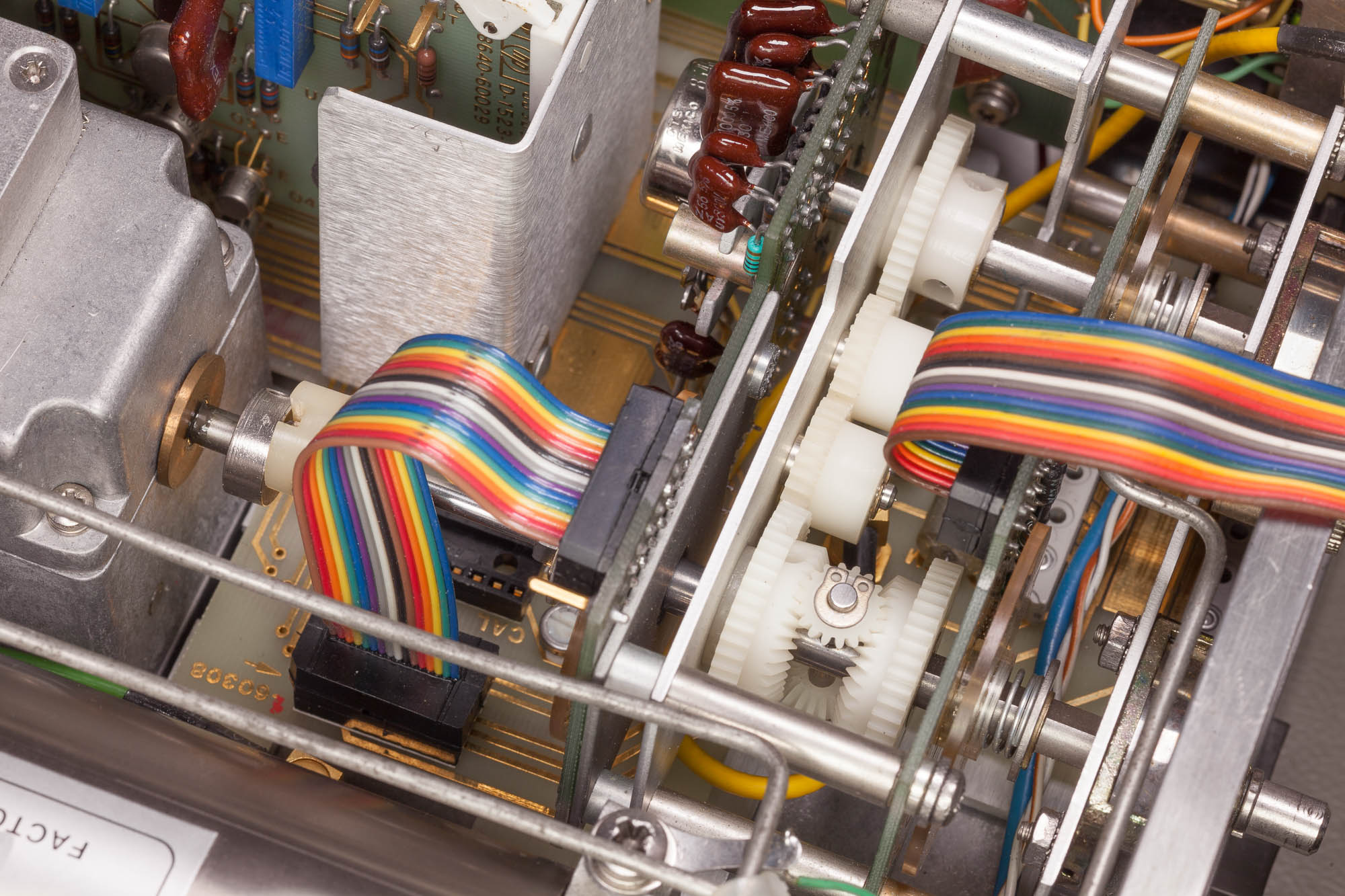

Happy with my HP 8640B signal generator. Restoration is complete.
After repairing the wipers on the A1S1 rotary switch, I also had to do the same on the A9 rotary switches. But the A9 module looked daunting to take apart:
However, the service manual has an excellent A9 assembly removal and disassembly procedure. Following the steps, and taking photo's all went well.
Now the 8640B was fully functional again.

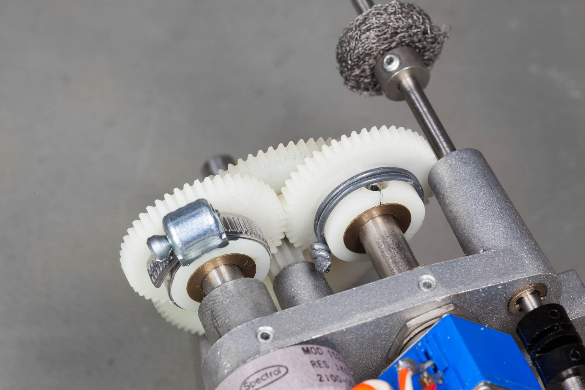

But I was not happy with the small cracks in the gears. It worked fine for now, but for how long?
I found small, 5mm wide open hose clamps:  Mikalor Open drive clip W2
I figured that if I clamp the gear, it will not crack any further. I used this clamp for the gears on the oscillator cavity:
Unfortunately, on the gear to the right, the hose clamp did not fit, the part with the screw was too high. So there I used another solution, clamping with iron wire.
Now the only thing left were the A9 module gears. I think the hose clamp will also work for the A9MP9 spur gear, but not for the A9MP12 and A9MP13 combination gears, with their 45° tooth angle.
I choose the easy way out, and ordered the brass gears from India. The seller was helpful, and the gears are very well made:
I had the A9 module apart before, for repairing the rotary switches with new wipers. So taking it apart again was now routine, and installing the gears was a breeze:

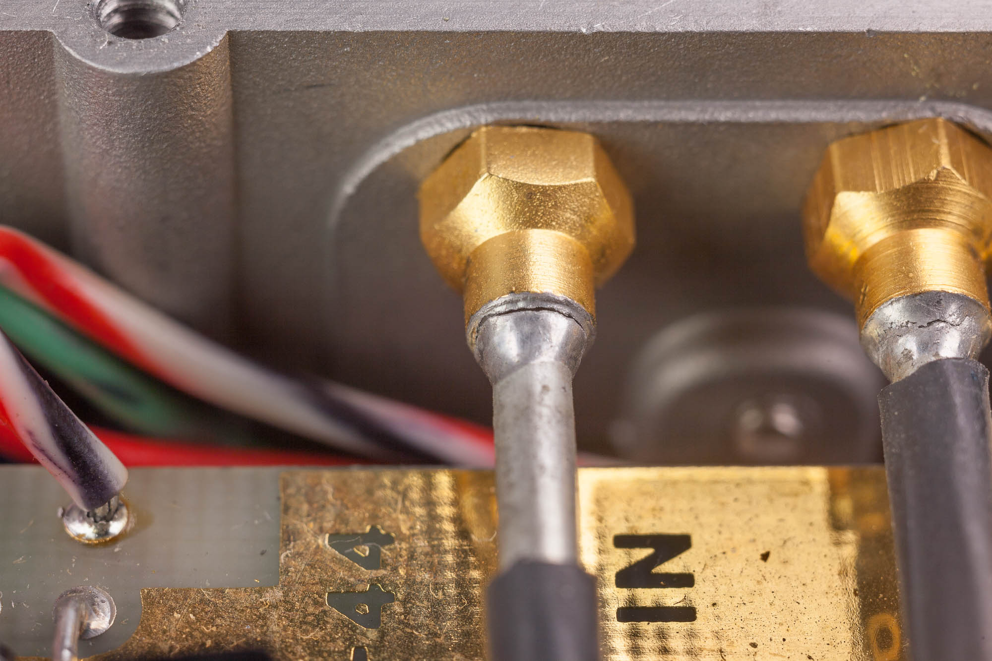

I did a spot check on the electrolytics on one board (A11 modulation oscillator), and found them all in spec (Alu and Tant, Sprague and Kemet, 30D, 150D and T110). So I am confident that the rest will be OK too. After 50 years!
With everything in good working order, I went through the 50 pages of the performance check. I found everything in spec, as far as my test equipment (SA’s) was not the limiting factor.
I did find a bit of variation in output level at the highest frequencies. And traced it to cracked solder on the semi-hardlines in the A26 RF output module:
And indeed, re-soldering solved the problem.

Are you familiar with this tool, a baling wire hose clamp? It could come in handy for making clamps for those broken gears. I've made several variants of this tool and find it incredibly useful on occasion:
Or an even simpler version:
It should be possible to cobble together a tiny version of this that would be perfect for those small gears. The result are very small, strong and neat-looking self-locking clamps using nothing but a piece of wire. (I've also made the much simpler and smaller variant as in the 2nd youtube-short, but can't find it at the moment....)

I did not know about the "baling wire hose clamp". It looks very useful for the purpose of clamping the 8640B gears. Thanks for the tip!
