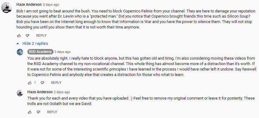

Here, read the transcript (or watch the video) of the conclusion from the video from Bob DuHamel from the YouTube channel RSD Academy.  He can explain it way better than me:
Dr. Lewin is disagreeing with the vast majority of the scientific establishment he's disagreeing with the vast majority of textbooks he is disagreeing with the vast majority of professors of both electrical engineering and physics and his postulation that Kirchhoff's voltage law doesn't hold is based on a incorrect application of ohm's law not knowing how ohm's law has to be applied to a voltage source.
Then he performs an experiment to prove his premise but he doesn't take precautions to make sure that the magnetic fields don't affect his measurements.  In the end he says “look at the math proves I'm right” well the math is right.  He is right about the non-conservative fields and the conservative fields, and if we put a loop of wire in that non-conservative field that loop of wire gets a current and the electric fields in the wire are still non-conservative.  But as soon as we either make a gap in the loop or put some resistance in there now we have a backup of energy where that gap is or where the resistors are, where, we get now a measurable voltage, a measurable difference in potential where we are now going up in potential and then back down in potential and we are no longer non-conservative.  We are now conservative so we end up with a conservative circuit or conservative fields in the circuit even though they're embedded in a non-conservative field.
And that's a lot of... alternative truths. To say the least.
But you probably won't find many confutations in the comments section, because Duhamel, like fromjesse, delete the comments that tell them they are wrong and why. For example, in his last video "Voltage in a loop is weird", a post by Silicon Soup stating that by putting the probes inside the magnetic region a voltage was induced in the loop has disappeared.
Here's the reason:
https://i.postimg.cc/vZ6BM4Wn/screenshot-3.png
Not so sure what is a "protected man", but I have some idea.
This has a lot in common with cults: silence the critical voices and surround yourself with bootlickers.
(and you have no idea how many other videos on this topic Duhamel has put out, only to redo them to correct the... alternative truths there were pointed out in the comment section. Now some of those videos are no longer listed and so the comments pointing out the... alternatively accurate statements are no longer visible.

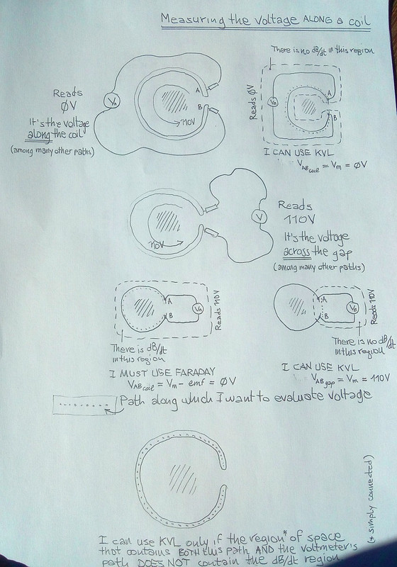

Humor me, guys. See the attached picture. All wires are actual wires and interact with fields, but have negligible resistance. R1 can be any value, I don't think it matters. Assume EMF=1V. Predict the voltages shown on V1 and V2, using KVL and Faradays Law.
V1 is zero, V2 is 1V. (didn't check the sign just saw the thumbnail), might as well be -1V
It's easy if you check if your measurement loop (voltmeter + probes + branch you want to know the voltage of) contains or does not contain the flux.
I'd say vice versa, because the path through V2 is not in the magnetic flux and the branch voltage is zero, so I'd think V2=0 and V1=1V (or -1V, I didn't check the field orientation either). If I'm wrong, I'd really like to hear your explanation.
Now I have a question for you.
Suppose I place a loop made with one resistor, the voltmeter, and its probes, near the magnetic flux region. Would you spend even a microsecond of your time to check that the induced field is being compensated? Or would you rather go: "nah, there is no flux in my measurement loop, I can apply KVL, no problem!"
Hm, I'd probably still picture the electric field vortex, because for me that's easier to visualize. But no I'd not spend any time actually checking, I'd know that if the field axis is outside of my loop area, the electric fields must sum up to 0. To me the electric field is somehow more "intuitive" because that's what the charge in the loop is interacting with.
Which is another thing I think I understood now: charge particles that are inert referenced to the magnetic flux are not interacting with the magnetic field, even if it's changing. Charge particles in motion (e.g. when you move the wire) interact with the magnetic field and experience Lorentz' force.
EDIT: Yep, the transformer trick would do. IIRC Big Clive used the whole secondary of a transformer to step down the voltage. From 240-->12V to 240 ---> 240-12V or something like that. Caveat: the current must be sustained by both windings.
In principle we could use the radial probing to extract a finely varying voltage from a solenoidal coil immersed in a magnetic field. Instead of going one turn at the time, we can have a continuous (well, only marred by asperities in contact) voltage from start to finish. Mechanical nightmare, of course.
I feel the need to add something to the discussion of the actual matter, Dr. Lewins experiment.
I believe what many of us participating in the discussion initially didn't understand, me explicitly included, is that Dr. Lewins experiment must be seen as a whole, including his choice of probing the voltages. The whole idea about formulating a "law" in science is to be able to explain and predict the outcome of an experiment, and as I already said but probably nobody really took notice, the test instrument setup including geometrical arrangement of probe wires is inevitably part of the experiment. Dr. Lewin proposed a circuit and the challenge was to explain the measurements, and quite honestly, you cannot do that with Kirchhoff. It doesn't work.
What Mabilde and "fromjesse" did was change the experiment until they could explain it with KVL. That's like, when you get some task assigned in a test and you cannot solve it, you change the task until you can. I don't think that'll earn you any points.
Mehdi came so close to the truth with his "+ V/2 - V/2" construct, but he was so fixated on saving Kirchhoff that he forgot what the task was.
For me that concludes the discussion. I've learned a lot in the course of it and I have a new understanding of electromagentism through it. I'll go back to the sidelines now for a while.

Here's a graphical depiction of the key, with an open circuit in lieu of the resistor
Source: https://i.postimg.cc/5yLyGRy0/Voltage-along-a-single-turn-coil.jpg
Not sure how you will find an axis with more complex configurations of the fields. My suggestion is to stick with the flux: does it cut the surface bounded by your measurement loop? If yes, then kiss KVL goodbye.
well, yes and no. When there is no flux cut, the choice of the probes is irrelevant. But you realized that.
What one sees by looking at the fields is that, if we limit ourselves to the only two possible paths in the circuit joining the points A and B on the diameter (don't know what Lewin calls these points, maybe A and D) it is clear that the path integrals along these two different paths HAVE TO BE different.
source: https://electronics.stackexchange.com/questions/551244/what-would-a-voltmeter-measure-if-you-had-an-electromotive-force-generated-by-a/551428#551428
(I don't understand why the images from postimage.cc do not show up inline, like this one).
Of course you can put voltmeters on the sides, but only the voltmeter forming a measurement loop that does not cut the flux will measure the correct voltage. If voltmeter and resistor run aroung the mag zone, then the voltage shown will be altered by the intercepted EMF.
Source: https://i.postimg.cc/QtVW6mc9/Two-measuring-loops-one-consistent-result.jpg
