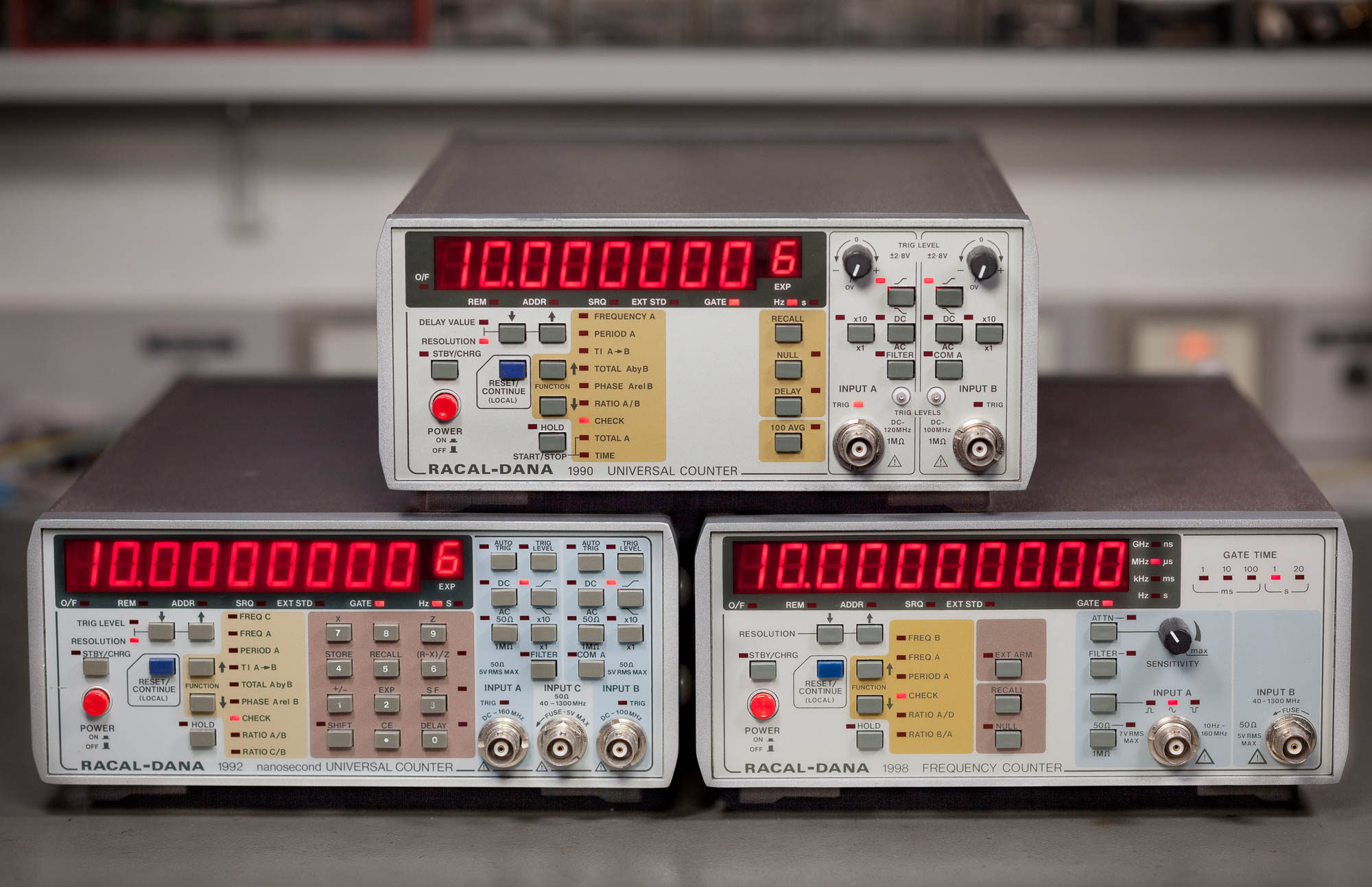

Racal-Dana 1990 universal counter
I really like the Racal-Dana 1999x counters, with their big red displays and 1mHz resolution @ 10MHz. The Racal-Dana 1992 and 1998 are my daily drivers.
So when I saw baby brother Racal-Dana 1990 at a radio rally, I bought it. I told myself I had to buy it for spare parts for the 1992 & 1998. But off course I repaired and polished it. :)

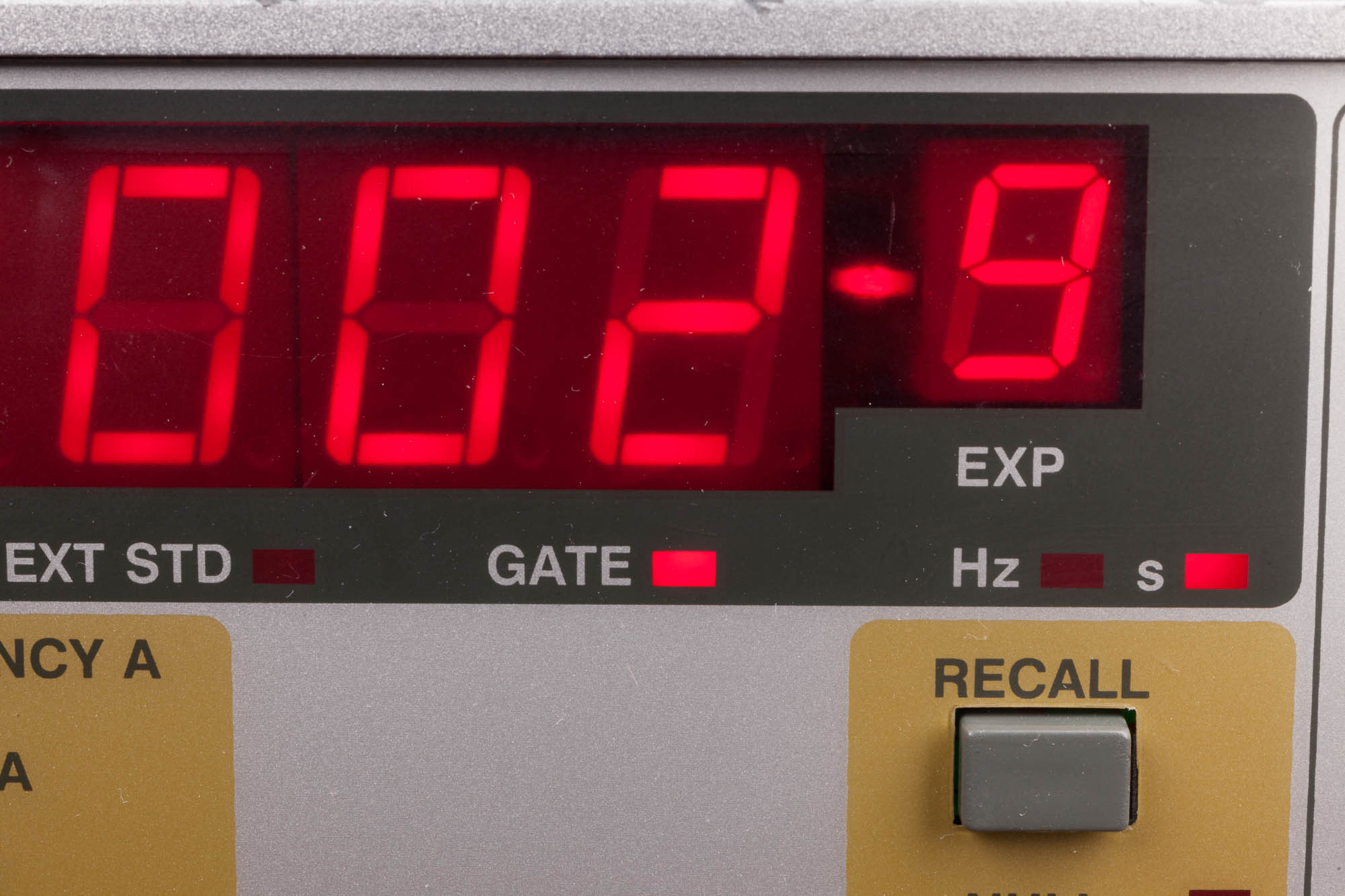

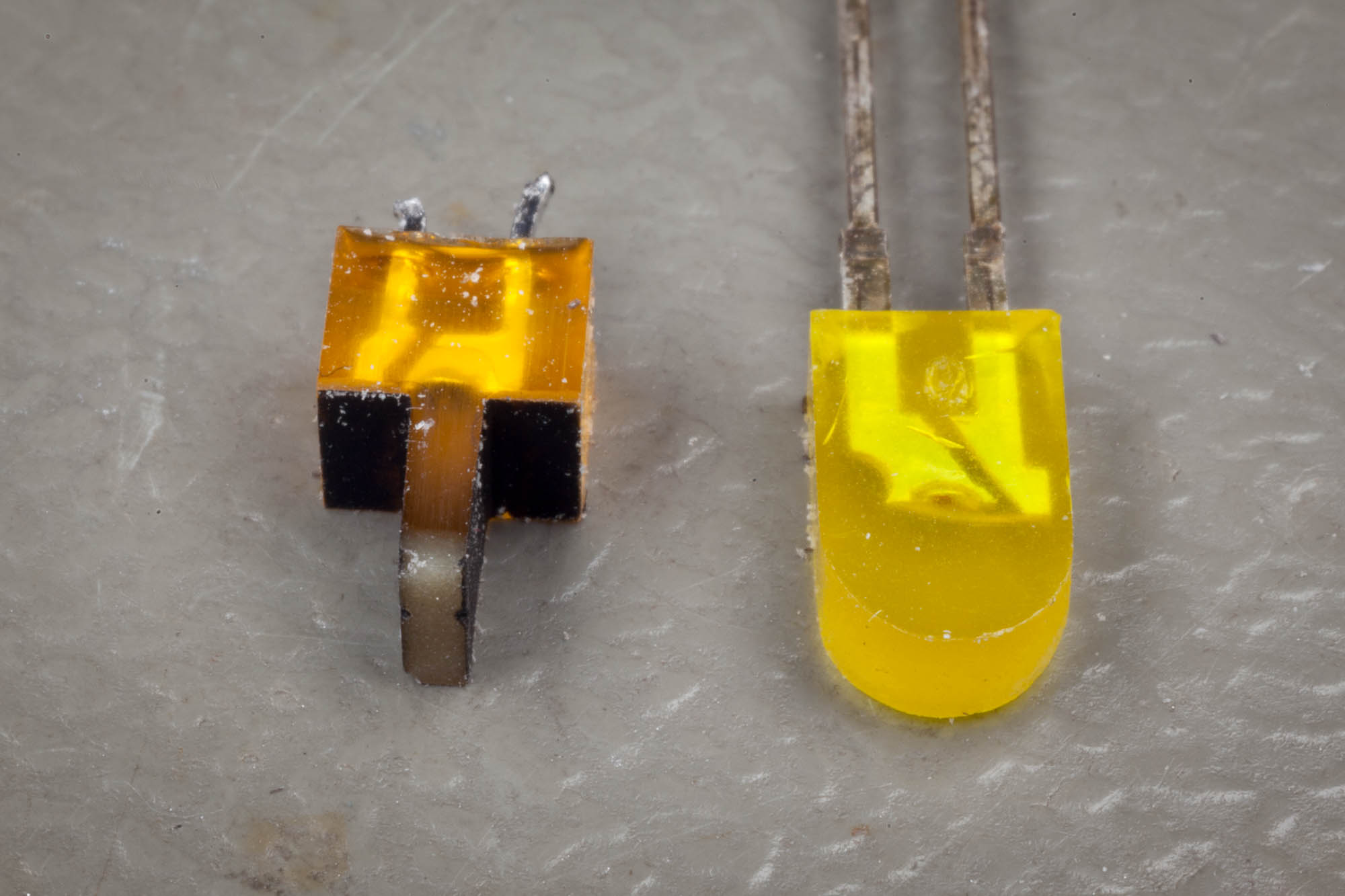

While checking specifications after the input repair I noticed that the minus sign of the exponent display was hardly working. A bit of measuring told me that the multiplexed source was OK, it was the LED itself that had aged.
This LED proved to be an uniquely modelled LED:
Of course I did not have such a LED in my part bins. So I decided to create one myself.
Original LED with some DIY replacements:
From left to right: original LED, replacement LED, and a failed replacement. That failed replacement LED shows the difficulty: The LED internal wire-frame is at right-angle with the minus-sign. File a bit too far and you'll hit metal, and the LED is broken.
New minus LED in place:
And the display with new minus LED:
With the new minus LED in place, this Racal-Dana 1990 was ready for use again. And even with less resolution this 1990 proves to be very usable.
It has functions no other 199x counter has: Time measurement, Total A, Delay and Averaging functions.
Trigger level settings are still the same after switching off & on again, and can be measured on the front panel.
It's 9444 OCXO is warm & stable in 8...10 minutes. In contrast to the 9462 Ultra Stability OCXO's in the 1992 and 1998, which are taking hours to stabilise. (For that reason I use the 1992 & 1998 almost exclusively with an external 10MHz reference)
The Racal-Dana 1990 repaired, and standing on the shoulders of it's bigger brothers:
regards, Gertjan.
Given that audiophools destroy old TE for the tubes, I think it would have been karmically right if you had destroyed an old piece of audio gear for the little rectangle LEDs in the VU meters...
Unfortunately the orientation of those LED's is wrong. The minus sign would be vertical.... :)
regards, Gertjan.
