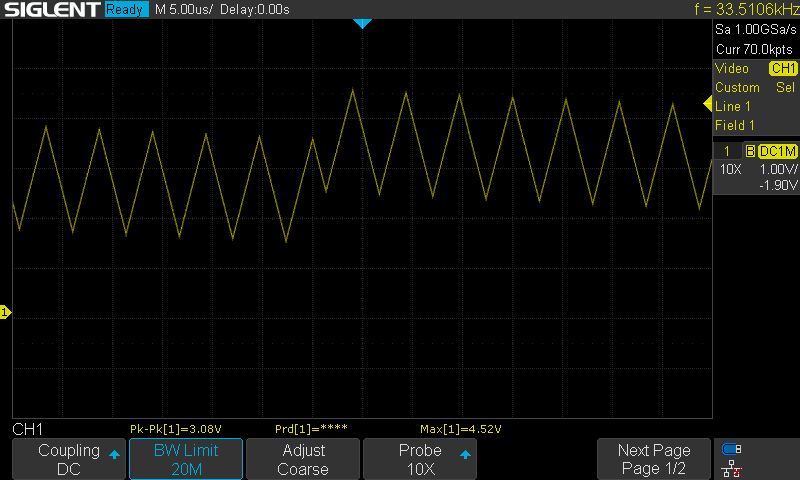

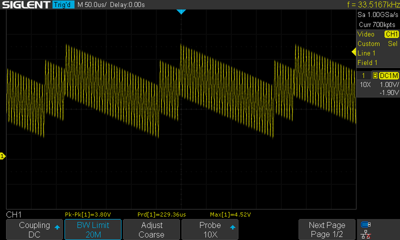

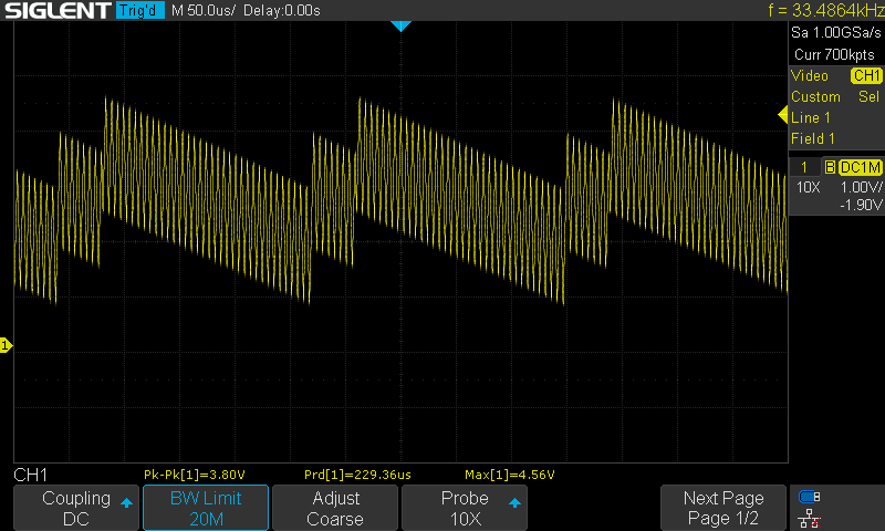

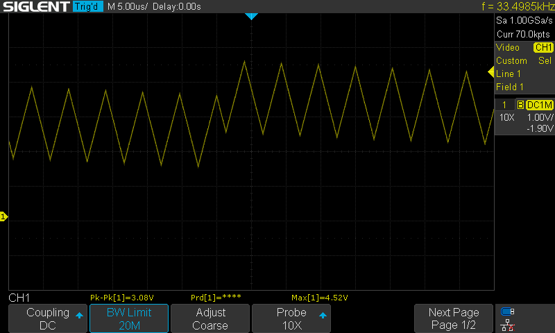

well , there is no option to change PLC , in 01A  Fast\slow 6 digit , i believe corresponding to 10 100, and same for 5 digits.
so ...
SET SLOW 6 DIGITS
here is integrator output , input shorted, means Vinput == Voffset to simplify it:
zoom to it slow 6 digits, 33kHz
FAST 6 DIGITS
zoom to fast 6 digits , about the same
and same zoom to FAST 5 DIGITS, same frequency
so integrator working with same frequency  generating the same rate of dataflow , regardless of PLC, and then some software calculation ....
I'm correct ?
so in hardware point of view, if it working on the same frequency, producing same digital dataflow , where is difference to change PLC and draw conclusion from it , where is my mistake ?
I'm sorry, "375 kHz feedback modulation"  I'm not quite understood about feedback modulation ...
« Last Edit: Yesterday at 07:07:28 pm by GigaJoe »
Online Kleinstein
  • Posts: 16916
Re: HP 34401A hacks and upgrades
« Reply #236 on: Yesterday at 08:02:04 pm »
The integrator works just the same, all the time. With a shorted input there is also no difference visible between a shorted input or an internal zero. So the integrator and feedback from the reference would be the same all the time and one would not see difference between data rates. The only difference is how often and when the µC internal ADC is read and used to calculate results. There should be one reading, than switching the input path and with maybe 0.5 ms range delay a 2nd µC internal ADC reading. The first reading is the end of one conversion and the 2nd reading the start of the next.
The frequency at the integrator still looks a bit odd. The 33 kHz is still a mistake from the scope: from the screen picture it looks like a little more than 1 unit of 5 µs. AFAIK the frequency should be a little higher. I don't know for sure, but there might be slightly different versions.
The pattern also looks odd, there should normally be a mix of short and longer sections.
Online GigaJoe
  • Posts: 745
« Reply #237 on: Yesterday at 09:34:05 pm »
174 kHz ..  ( honestly i didn't count , just look at freq. meter ... )
so your reference to 375 kHz feedback modulation related to this frequency ?  now i get it ... as i assume 30KHz and whatever switching spectrum would be far away ....  ok .. need to think ..

The 174 kHz would be roughly half of what I remember. There was also a different waveform with extra wiggles. To get 3 µs range feedback steps this would need the the up and down sections to be separate feedback steps. So the Frequency is not that much off - I mainly miss the extra wiggles to make sure to a fixed number of switching events.
One possiblity could the use of a different feedback pattern, following the US5200752 patent. The waveform looks a bit like this. At least with my ADC implementation it did not work out and I got INL issues. I don't understand the exact reason and with different hardware it may not be all that bad.

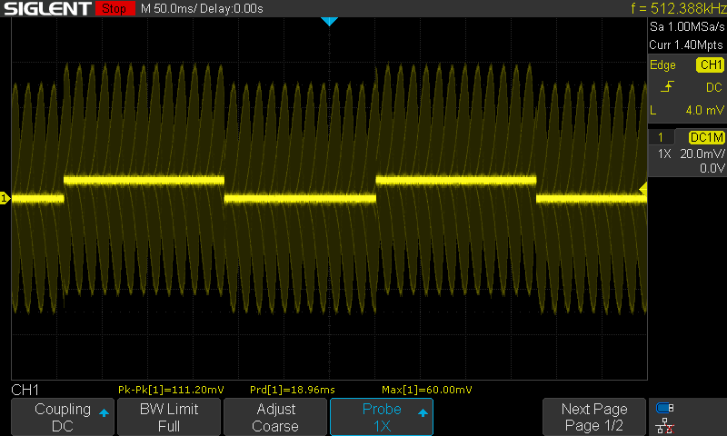

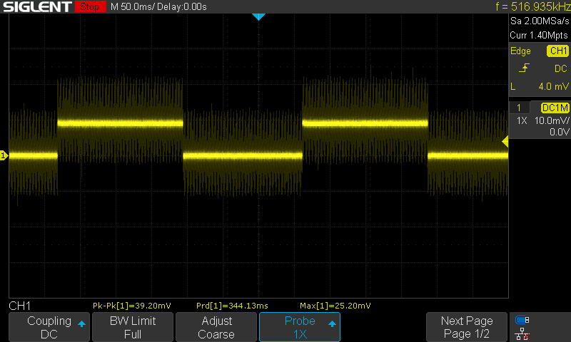

Online GigaJoe
  • Posts: 745
« Reply #240 on: Today at 02:30:38 pm »
damn ...   that it ....
Good unit:  input 10V:
from DC ampl perfectly square 10V [ADIN] going to HP chip Pin15  ; output Pin21 around 100mV   [ I would really happy if someone explain to silly man, why output not  match with schematic ]
R440:  https://i.postimg.cc/Y01vjwWM/SDS00032.png
and integrator's OP27 output as iMo posted 600 mV .. ish
noise unit:
DC ok 10V square [ADIN]  in P15;  output Pin21 - 30mV [bang!]
R440:  https://i.postimg.cc/x1F1fd4H/SDS00035.png
and integrator's OP27 output around 30mV  [bang!]
so it roughly running at much lower input , making more noise ... and all my mumbo-jumbo definitely drop some noise , as i see some improvement but didn't cure.  bandages doesn't heal ..
now:  as i suspected HP chip defect ... schematic lie and 100K resistor really not  between P15 - P21 ...  and now what : Bandage some few hundred K resistor P15 - P21 to bump voltage ?  silly but may work ..
PS: and funny thing , it able to pass test, and accept calibration, and even shows acceptable result , consider noise level, and skewed adc voltage input ... wow ...
« Last Edit: Today at 02:35:30 pm by GigaJoe »
