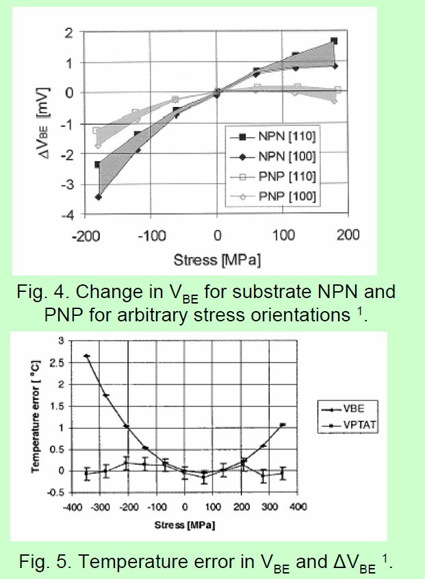

The LM399 shows two possible entrys for a temperature change related mechanical stress effect. The first and most reasonable is that the regulation temperature change with mechanical stress. The second would be that the buried zener voltage change because of the stress. The second argument is not reported up to now but for the first argument there is much material.
from:
Package Shift in Plastic-
Packaged Bandgap References
Vishal Gupta
Prof. Gabriel A. Rincón-Mora

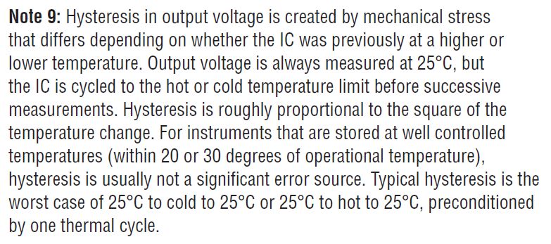

So the hysteresis effect is reported by LT as be a square law dependence on the temperature amplitude.
To my understanding the aging as well as the temperature hysteresis depend on the mechanical stress change of the die attach epoxy over temperature and time. If the temperature change for instance at warmup or at the start of the burn in mechanical stress will built up but will realease after some time to lower level. This effect will repeat but with memory from previous cycles.

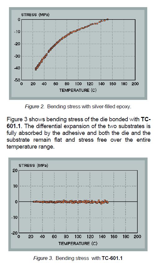

Zymet Zero-Stress Adhesive
There are alternates for bonding. Interesting is the reduced stress at higher temperatures for silver-filled expoxy. But the zero-stress point is above 150°C.
So the best burn in will be at target operation. A burn in at higher temperature will possible leave a greater stress at lower operating temperature. The effect will either change the regulation temperature or direct the bandgap voltage. So it will impact the obsolete LTZ1000 and LM399 buried zener as well as newer bandgap based designs.
