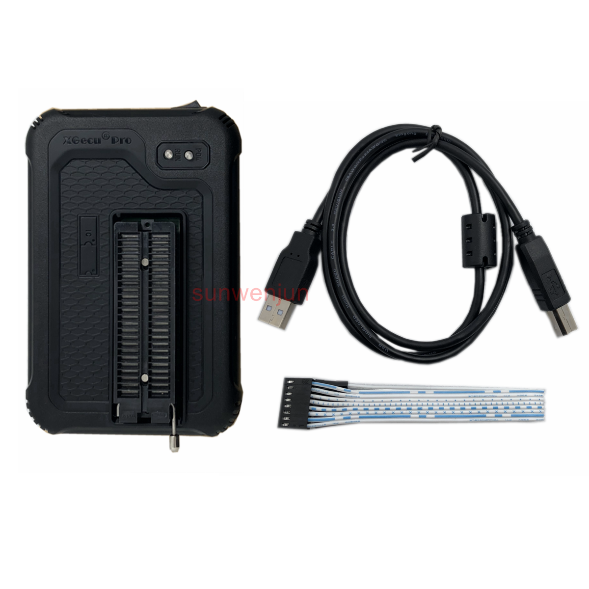

It looks like the company has made a new product called XGecu T56 with 56-pins
http://forums.xgecu.com/redirect.php?tid=19&goto=lastpost#lastpost
They are a bit pricey still, but I like the design  :-+
