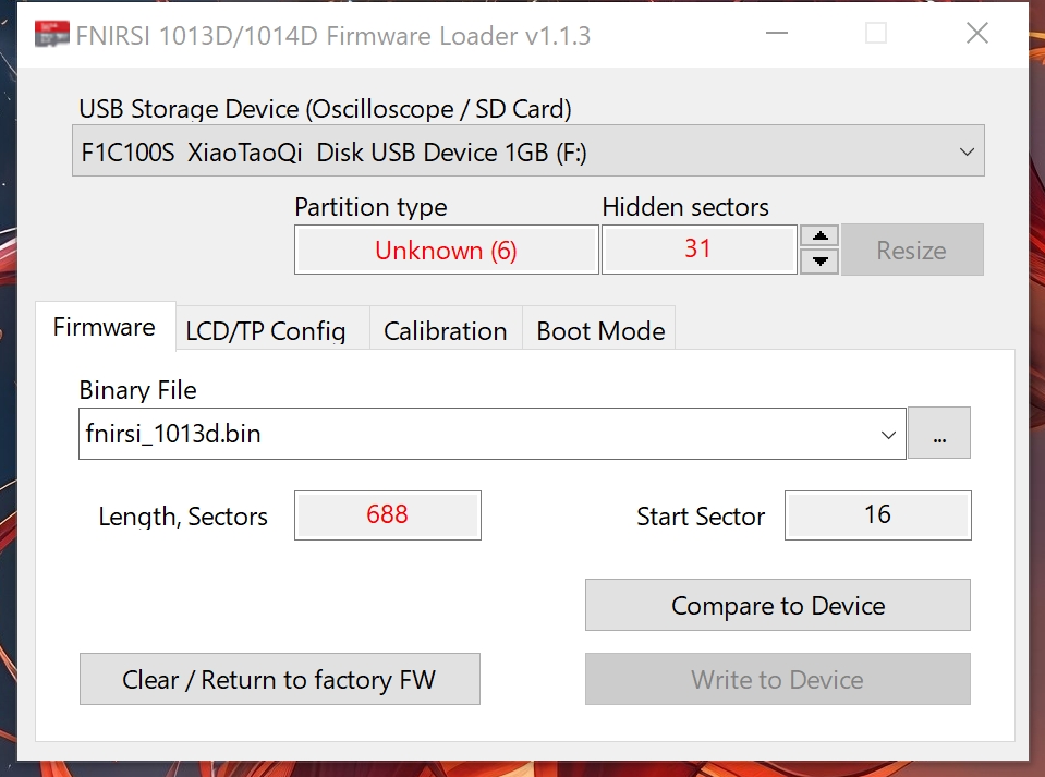

Thanks for the great work on the alternative firmware.
I tried to run the loader program on windows 10, like the video instruction does, Program was running as administrator.
however the "write to device" is not enabled, why?
Is that the factory 1GB SD card is too small?
I also tried with earlier older firmware, enable or disable boot menu, same problem.
The scope already has the latest factory firmware loaded.
Try formatting the card, the procedure is in the firmware instructions.

I've tried to format the USB drive when connected to windows, after formatting the loader still don't let me write to the device.
And then I reboot the scope and it says SD Error and doesn't want to boot.
I end up find a Samsung 32GB TF card, using card read to load the firmware and plugged into that which is running fine now.
The original TF card is a no name no brand 1GB TF card, guess at that time FNIRSI is still going hard on saving cents on material.
Regarding the firmware instruction, I read the description of the firmware page on github, also read the loader's readme, doesn't seem to mention about format the SD card
Someone said that developers don't make guides. Why, because no one reads them anyway, and making guides takes a lot of time. There's definitely a GUIDE on github. Also here on the site
Thanks, found the guide on github under the folder Guide to firmware.
Actually I did looked there twice but didn't notice that file is the guide itself.
Because it looks like just as another firmware but not a txt or doc. Also the file name been trimmed so it's a bit
tricky to pick up. Anyway I'll read through the guide, thanks again.
