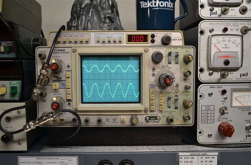

Here's my older unit. Still going strong. Firmware not required.  :-+
Now to find a buyer for the DS1102E. Should be able to get a few bucks for it.
